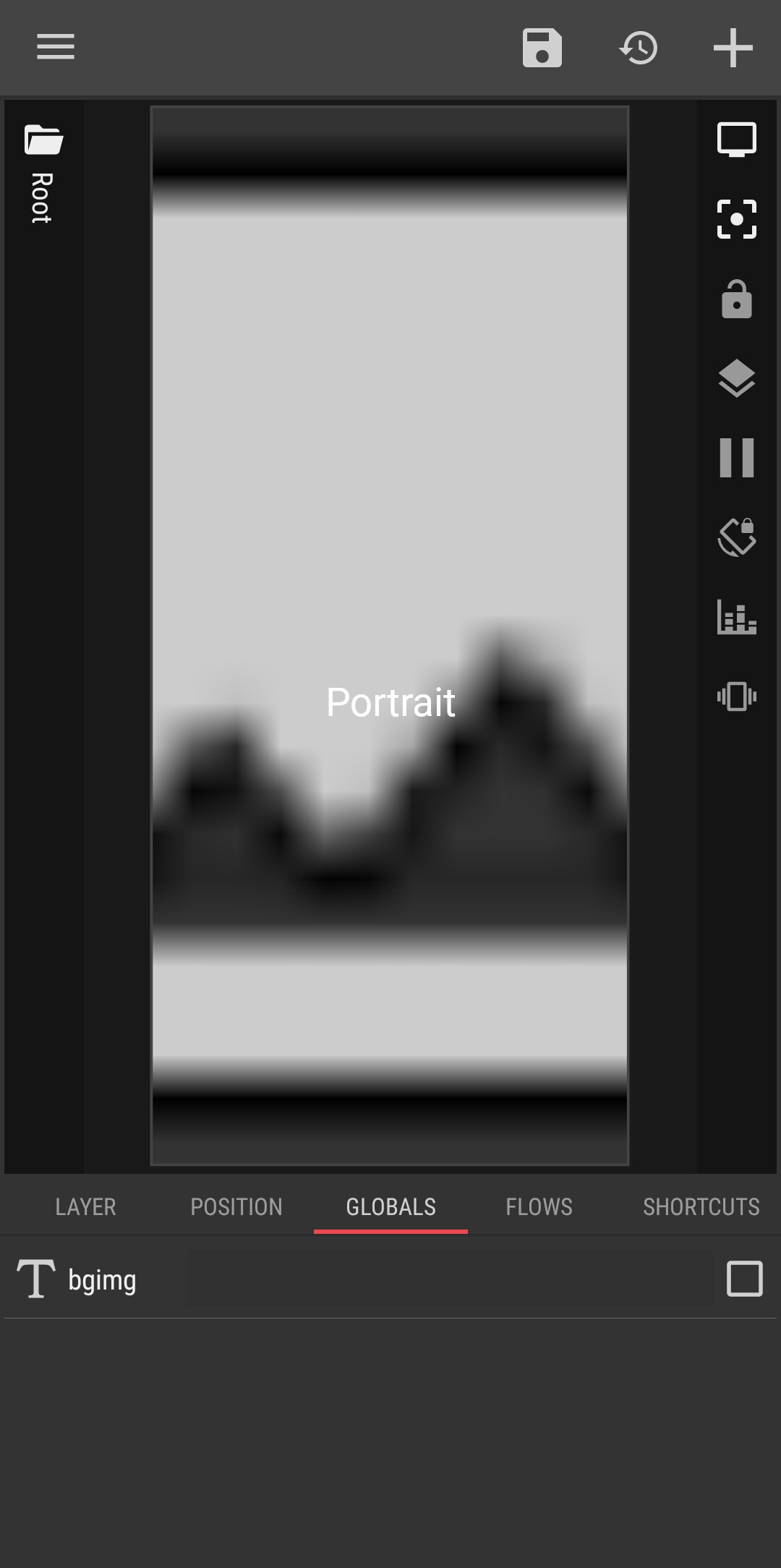

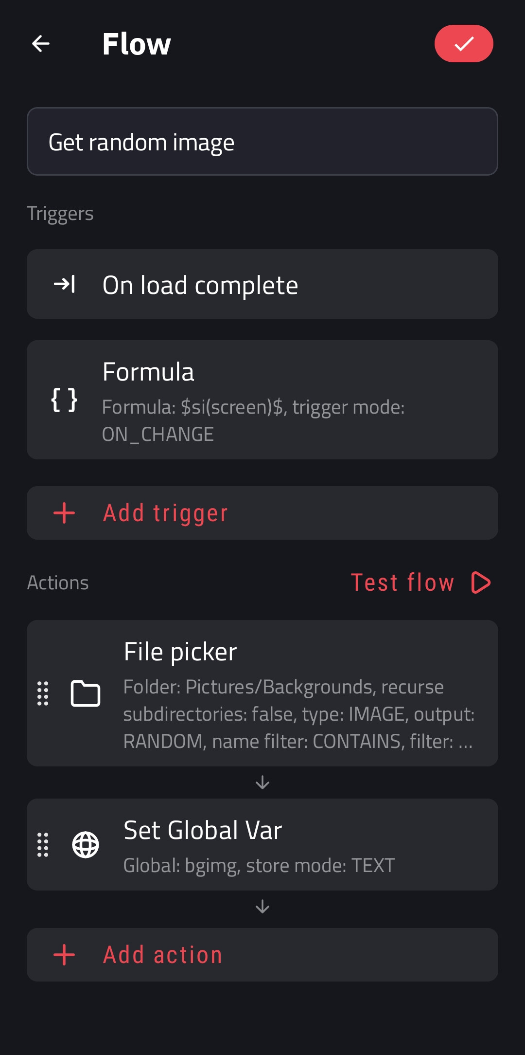

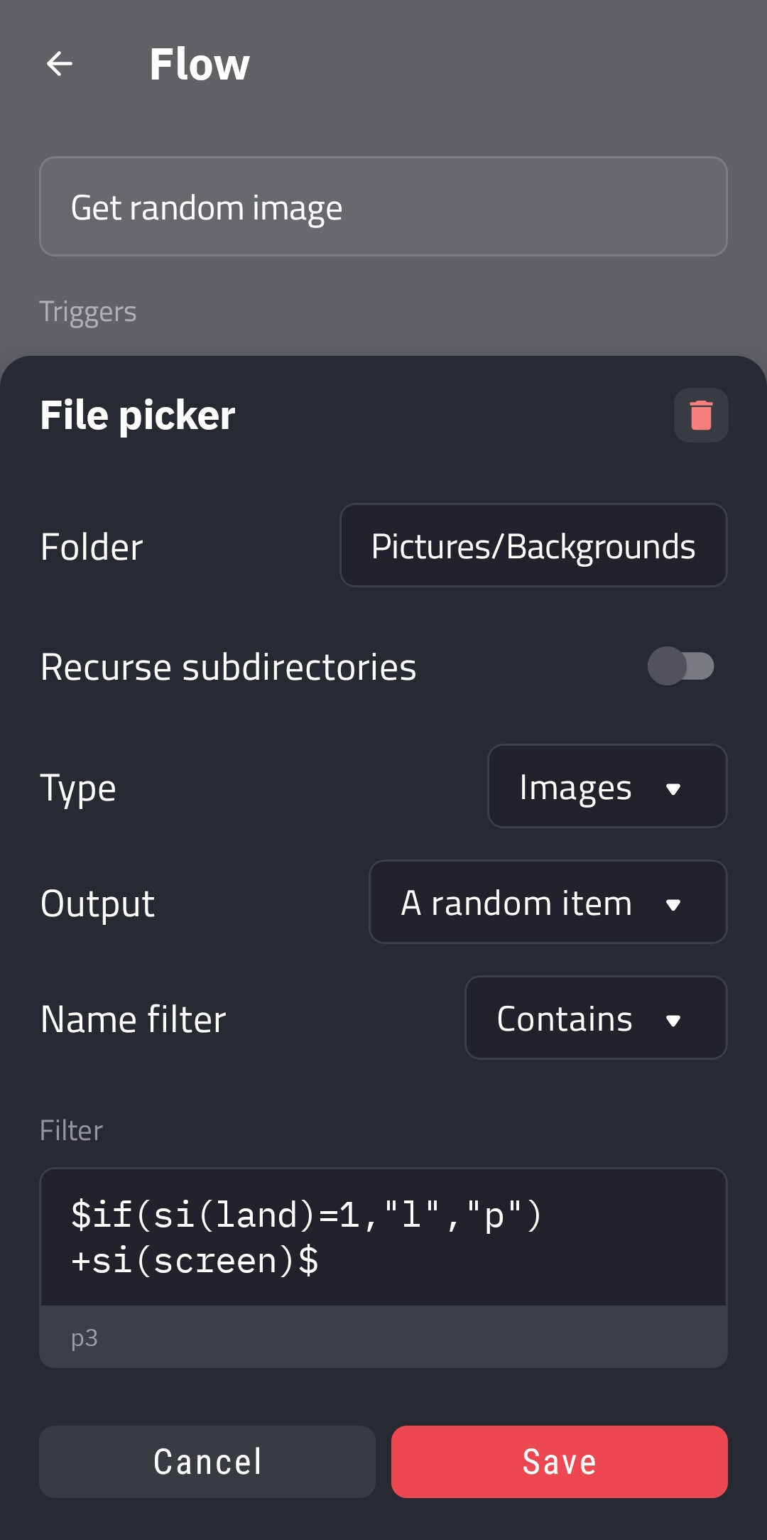

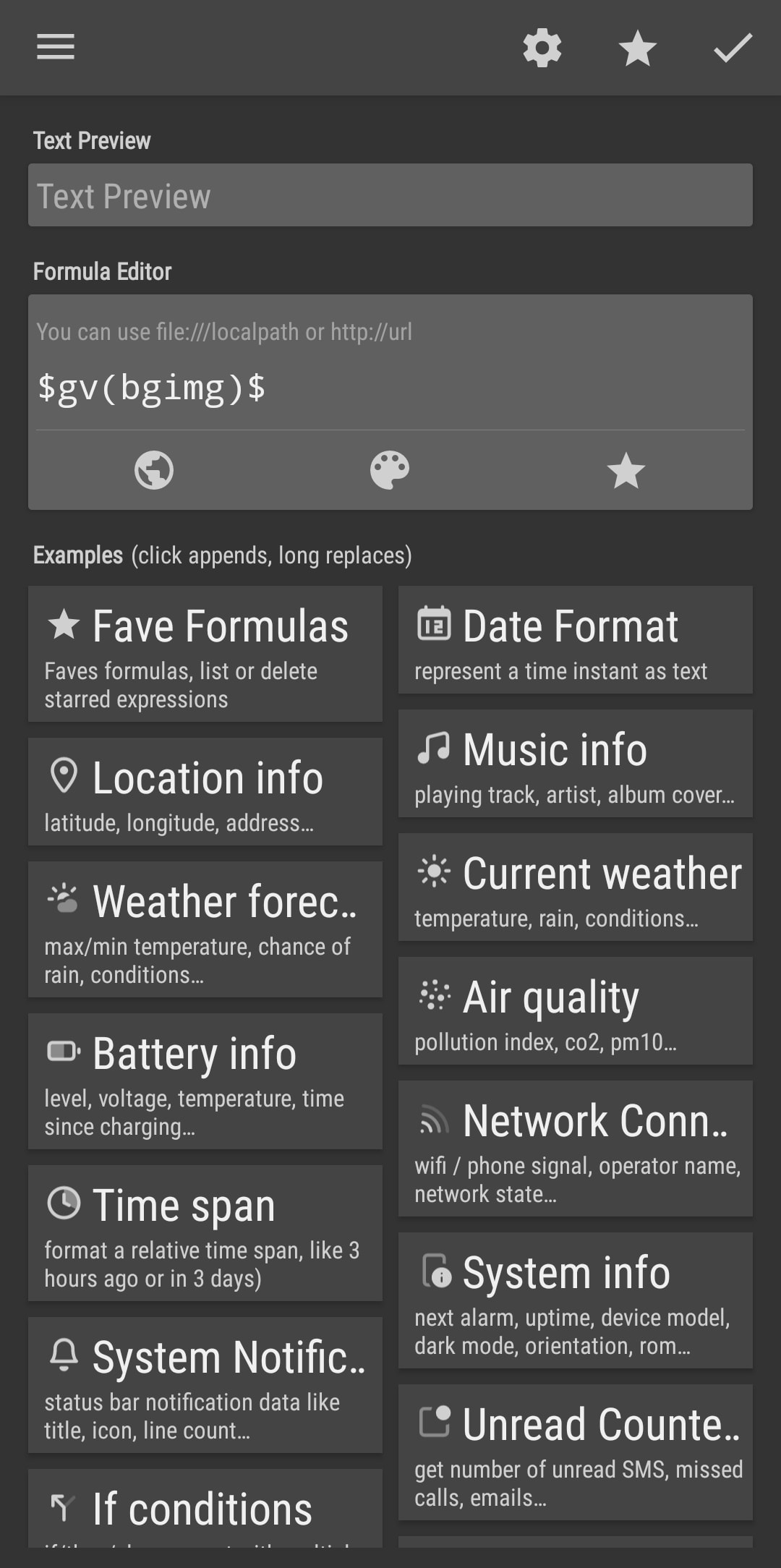

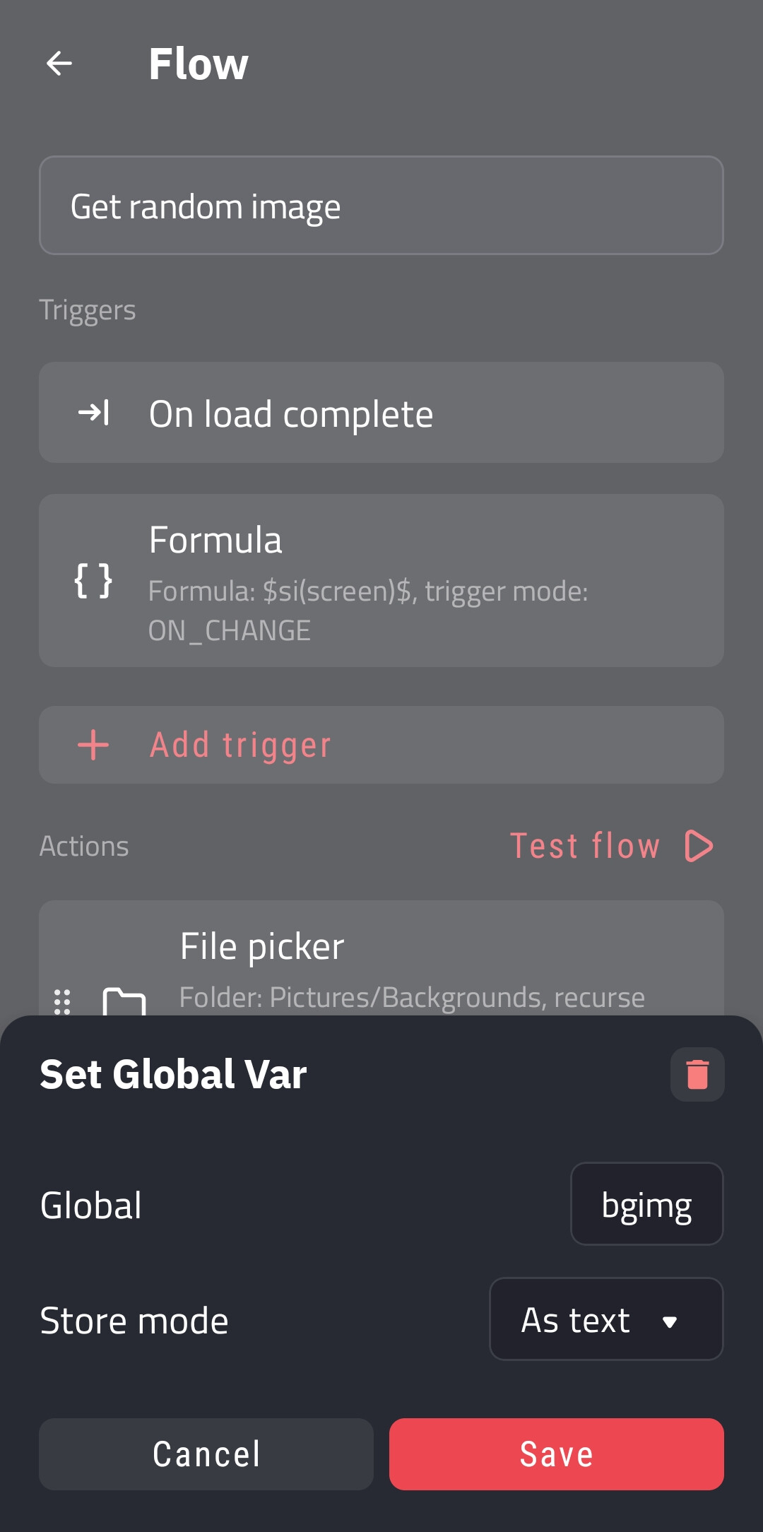

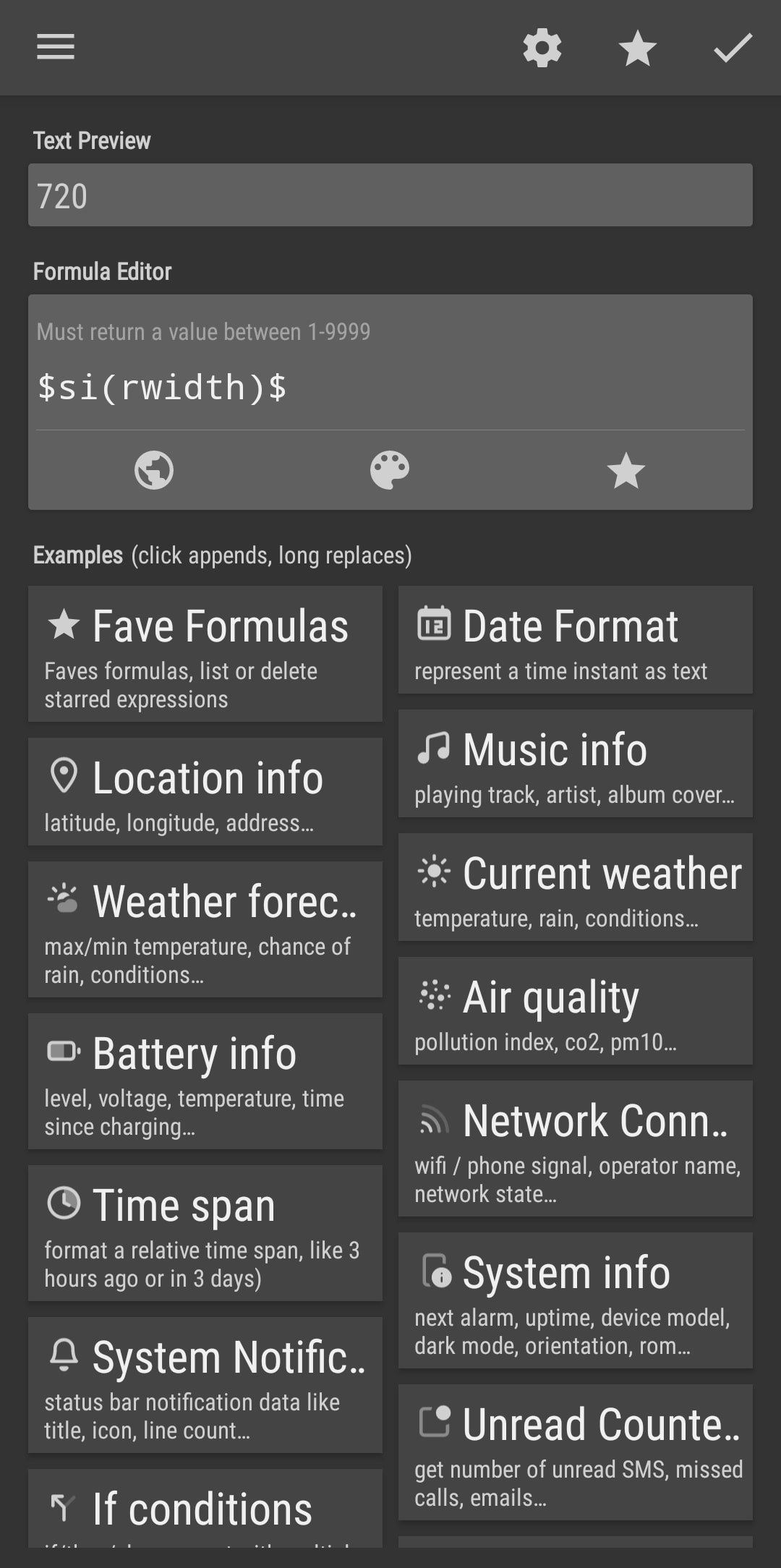

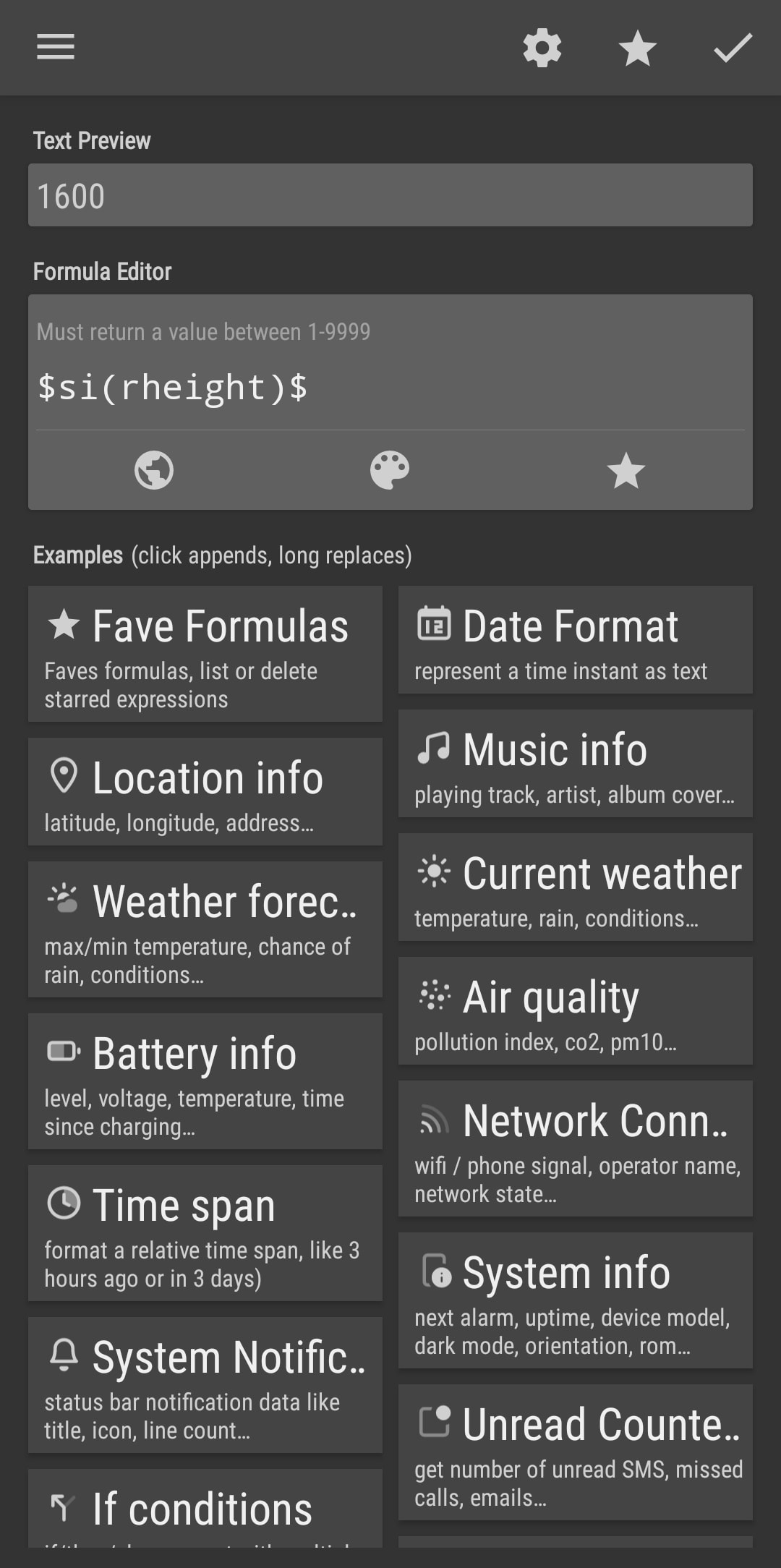

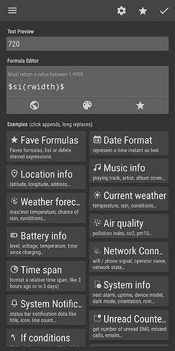

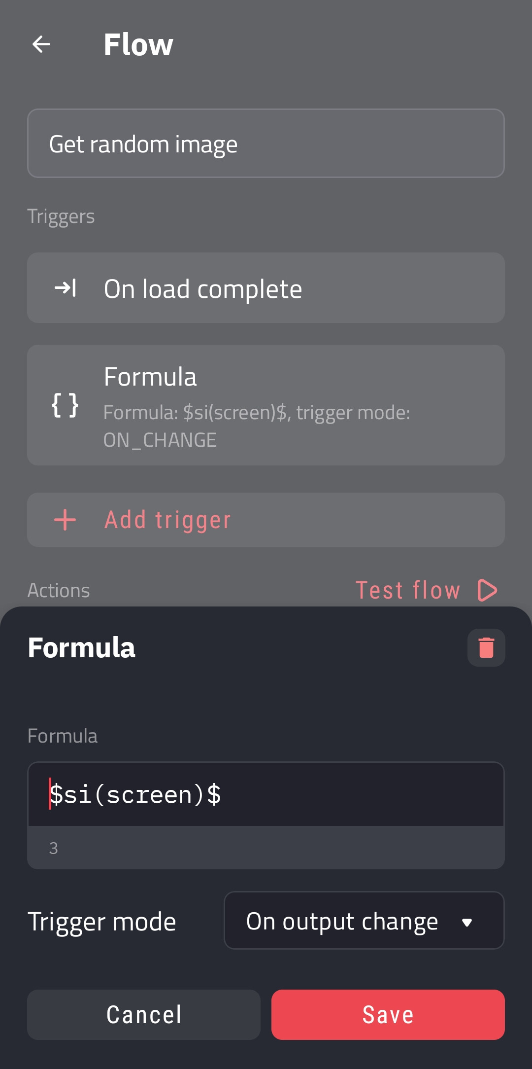

Would you like to try to manually recreate the preset?
Here are the screenshots for the steps (tap the thumbnails to view the larger screenshots with their captions):
Thanks very much Baju, that did the trick
