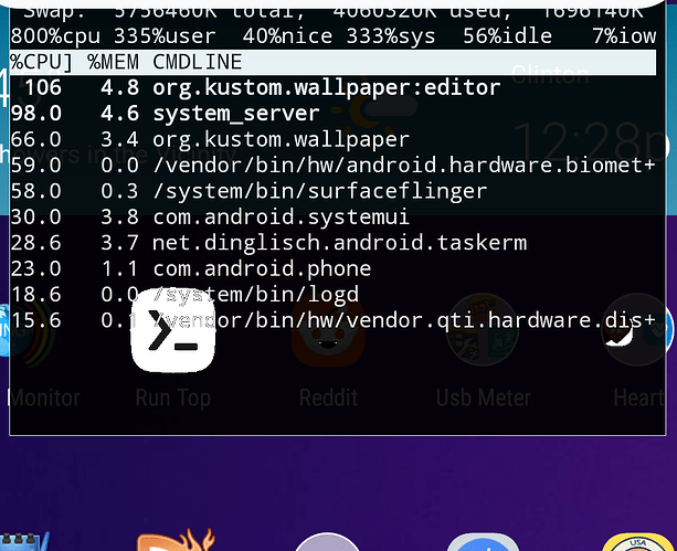

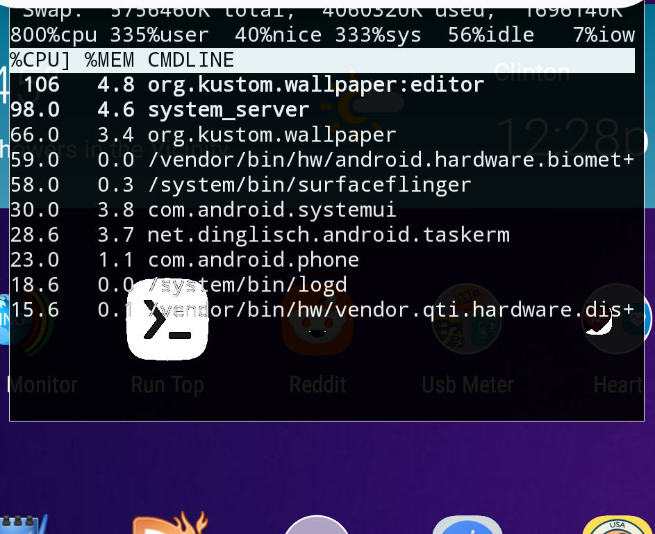

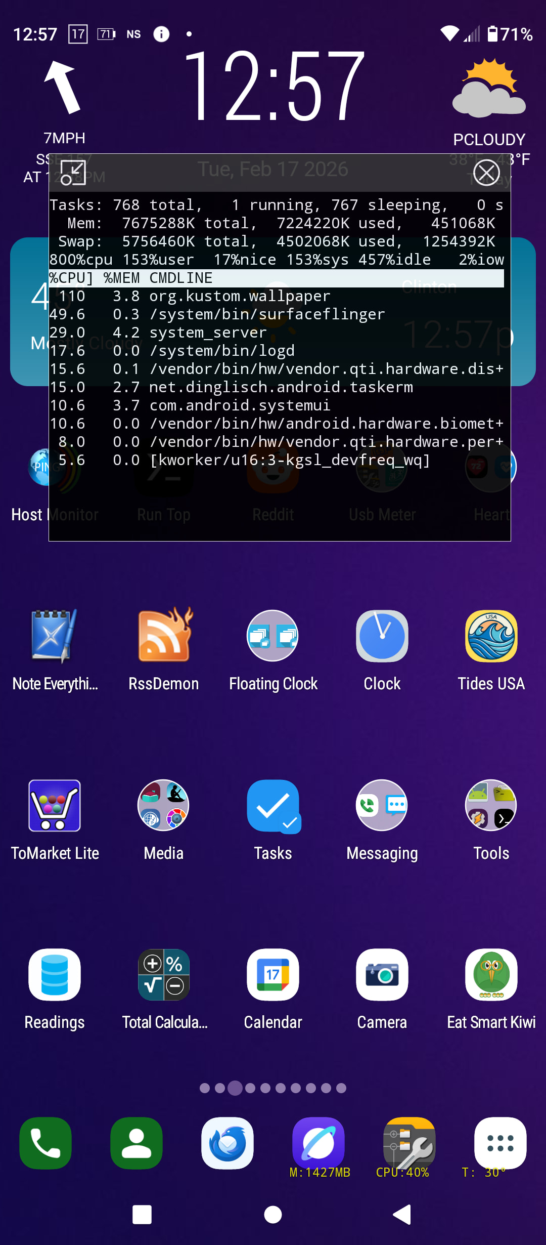

From the time I boot my phone until the time I actually start the editor, KLWP has no problems I can see. The “top” command shows it using 30-35% most of the time - perhaps a bit higher when it is running some flows.
As soon as I start the editor a new process for the editor is shown in the “top” command. Even if I do nothing at all except open the editor, this process jumps to at least 85%. If I start doing almost anything, the process jumps to 95% or more.
After opening the editor, doing nothing, and closing the editor, the non-editor process returns to its “normal” shown in #1 pretty quickly.
If I open the editor, do just about anything - say change the padding on an item’s location - it seems to lag alot. When I try to close the editor, it keeps asking me over and over again each time to save or not - even though I have answered yes on the first time. I can see the editor report that it was saved but the prompts continue on and on. Finally, I have to just answer Discard to get out back to the home screen.
At this point, the KLWP process (not the editor process) goes way high with % reaching at least the high 80’s and sometimes higher. I also not that at least some of my flows start acting strange and producing odd visual effects - almost as if the flow gets stuck at some point and then the flow is re-started and again gets stuck - maybe at a different point this time. This continues and continues. If, after some time, I reboot the phone, it all starts again at #1.
