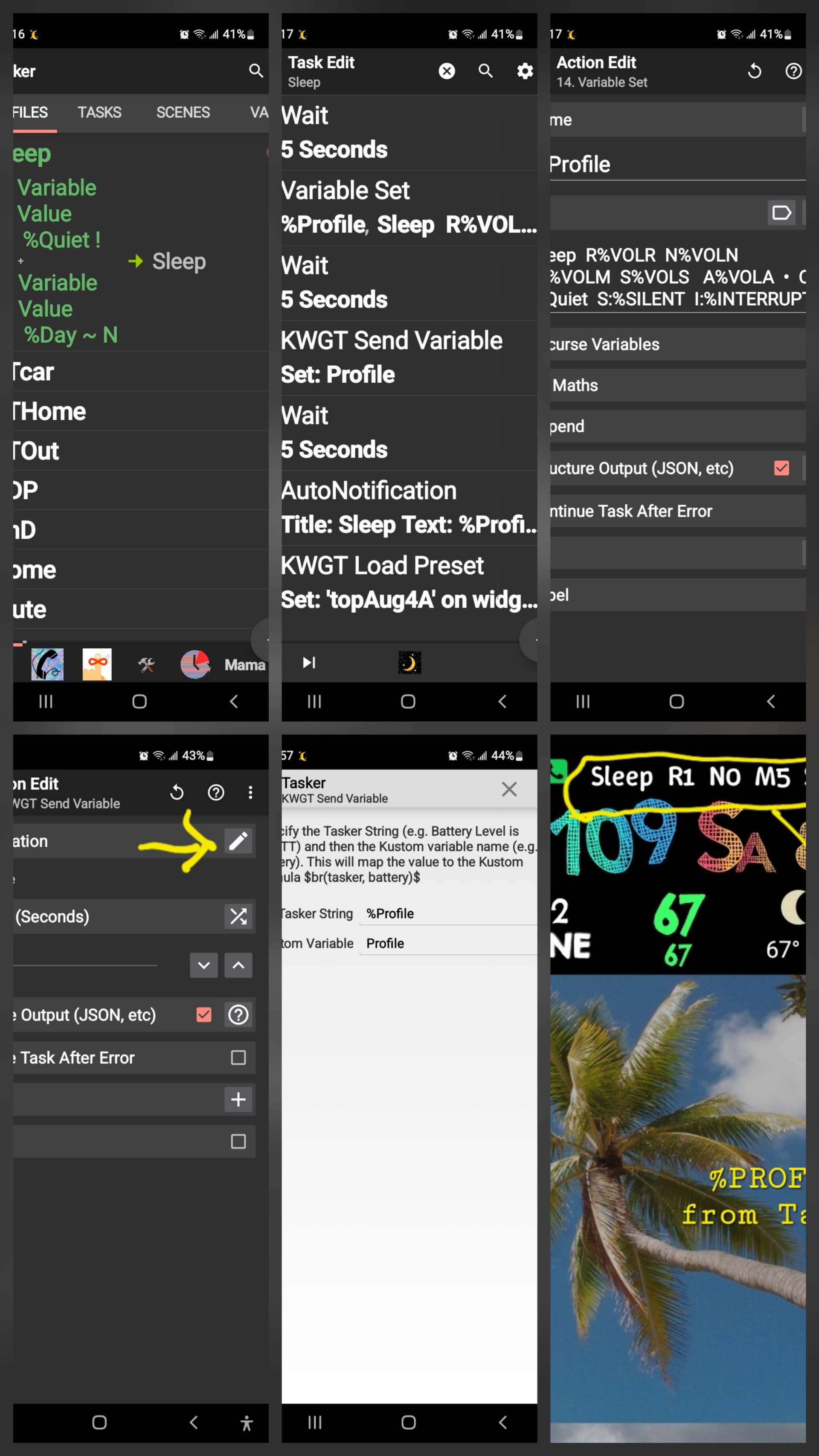

Hi. I will try to answer in the order asked. #1 to send a variable from Tasker, there aren’t really enter and exit tasks for this. What you want is to create a profile that will trigger the variable to send. This “trigger” can be when a certain app is open / running, time, triggered by another task, incoming call, etc. Connected to this "Profile is the task that will run when conditions are met. I’ve been using Tasker since about 2014 and Kustom since about 2020 but every day still seems like a new adventure. I will attach a profile of mine and the task that sends variable to Kustom. I will do another reply tomorrow after I look at number two of your questions. I have a vision disability so I can only do so much screen time before I have to stop. I am attaching a sixth screenshot that shows you my custom widget that I use on my phone. It has all of my settings at a glance so that I can see the volume and stuff like that.
I forgot to show you how to get your variablevto actually show in Kustom. It will only let me attach one picture a day so this is screenshot number 7 if I could send it
Kustom:
  1. <+>
  2. Text
  3. The formula for this is in the “broadcast” section but here’s my specific formula, you can cut and paste this and put in your own variable name. $br(tasker, Profile)$ custom is picky about capitalization & spaces matching exactly so be mindful of that
