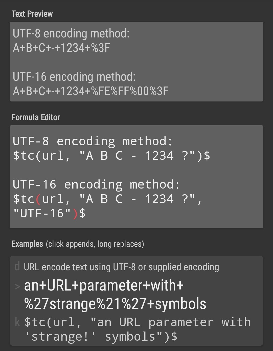

$tc(url, "the original string, like URL-address.", "UTF-16")$

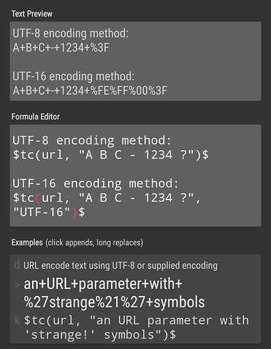

This screenshot shows the description of the tc(url) function indicates the UTF-8 encoding method is used.

I just tested all ascii characters and the only whitelisted characters are *, -, _ and .. is converted to +. [A-Za-z0-9] is left unchanged. Everything else is converted into the UTF-8 (or the specified codepage) byte representation (%XX).
That rules work for my cross-platform needs.
