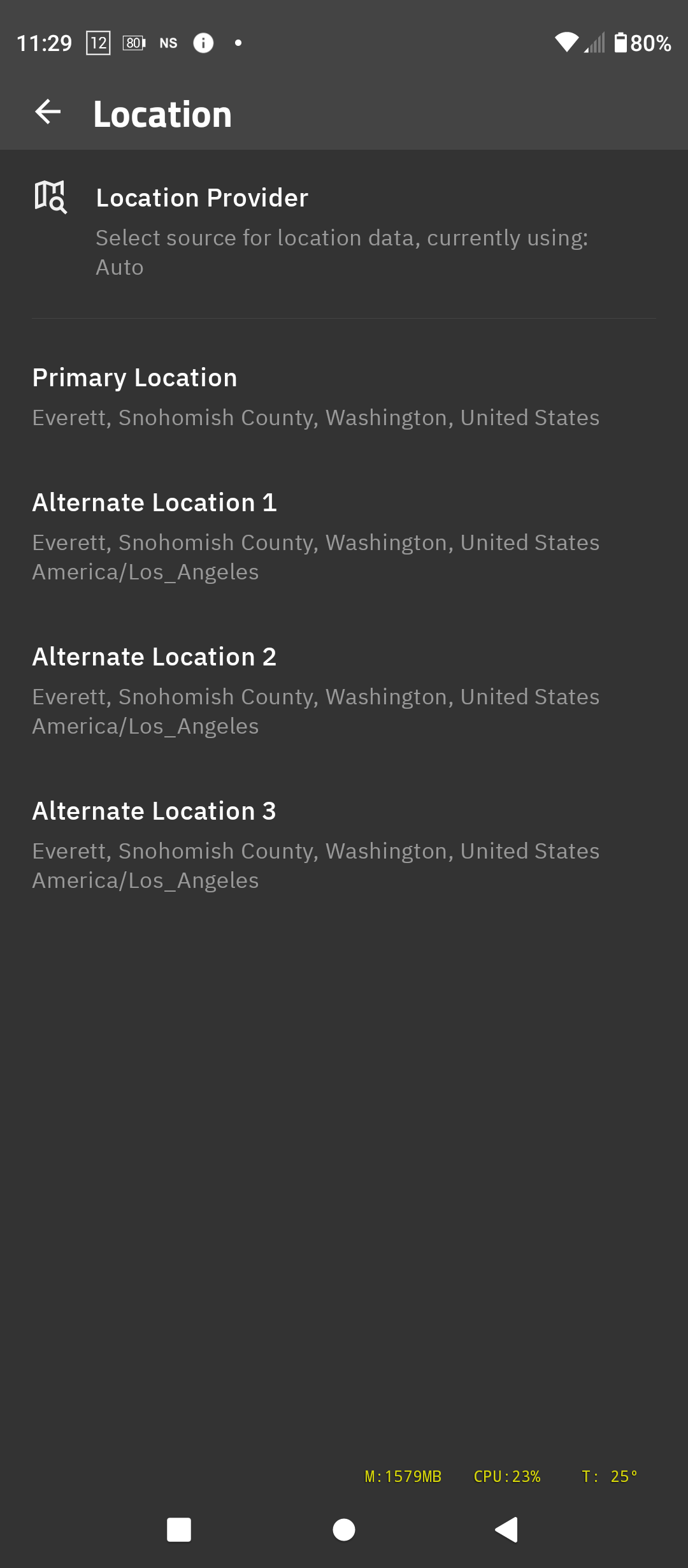

I did not speak to the layer’s location. Actually, I have never even looked at or touched that in any of my wallpaper. So it is whatever the default is. Here are my location settings:
As you can see, I am not very concerned with a location other than the one place. The device in question is NOT a portable device. It just sits in a cabinet as a server. So I set them all to the same place to avoid any confusion. So if I understand you, the updated mechanism should be applied only once per cycle and only for the top-most location. If this is true, it creates a very deep mystery for me as to how/why I get so many triggers.
