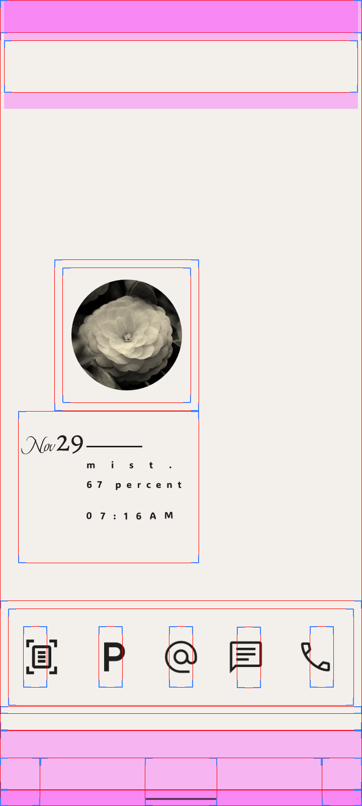

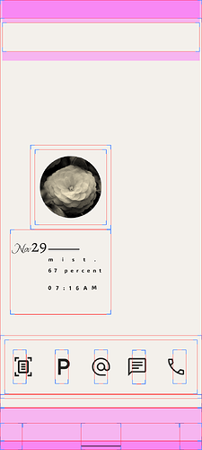

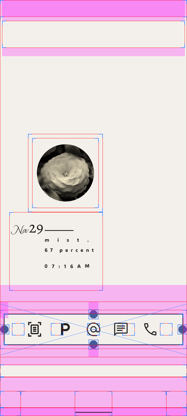

I am recently facing this issue. I made a widget for launching apps. When i resize it (smaller). It’s touch layouts misaligned (can be viewed in attached ss) and touch won’t work. Resizing back to large It works again. I want smaller icons and in one widget.
The icons used are svg bitmaps. Tried fonticons but same issue. Am I missing something ?
Have you tried to wrap each icon with an Overlap Group or a Stack Group? And set the touch action to that group instead of the icon element.
A question: How do you set the size of each icon? Do you set the icon’a size dynamically (relative to the widget’s size)? Perhaps it affects the touch.
