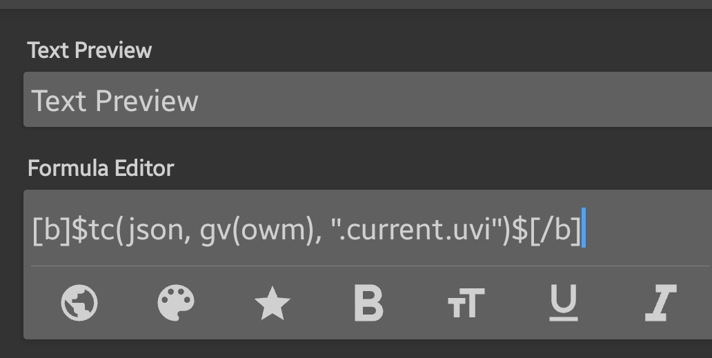

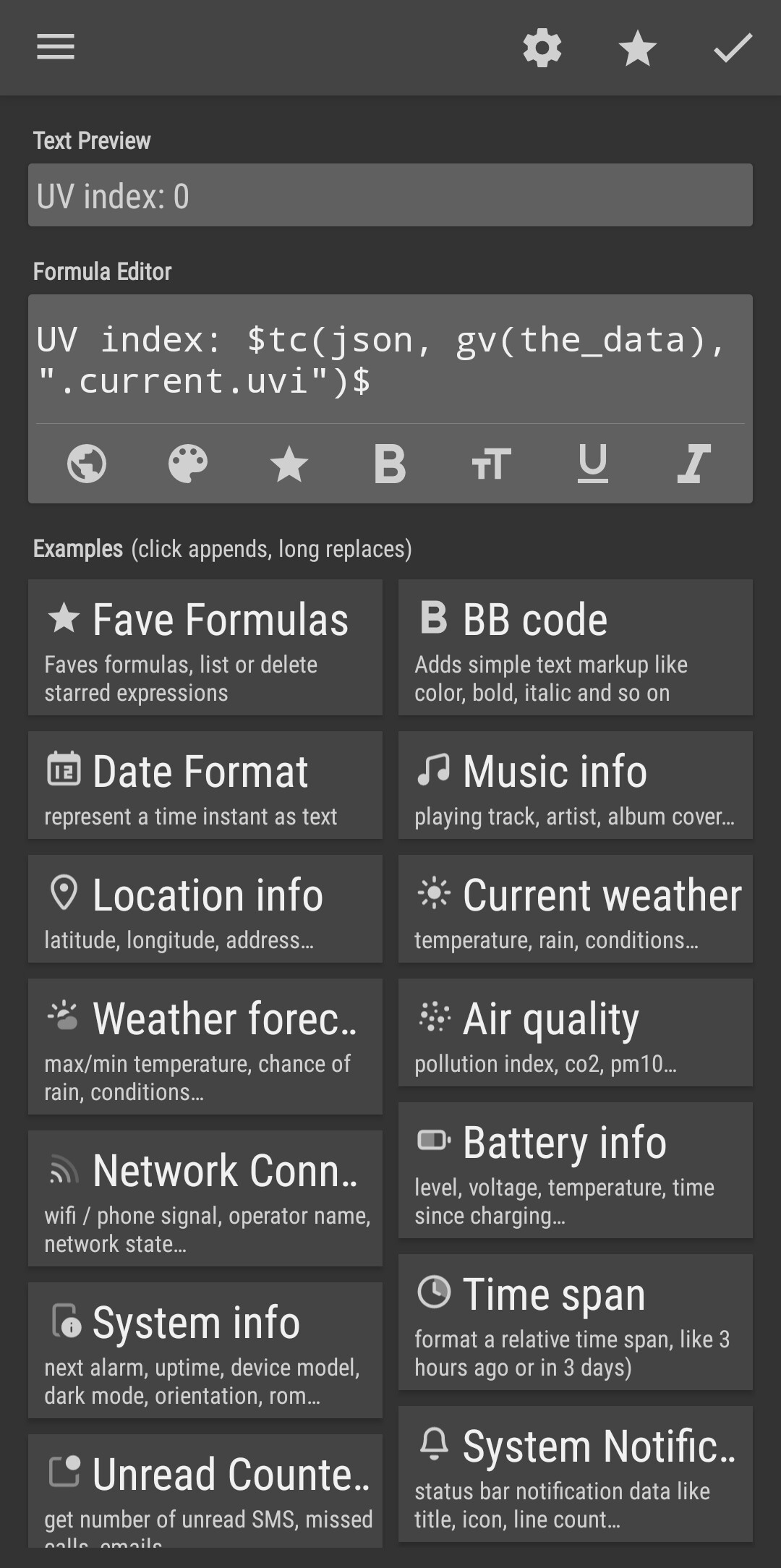

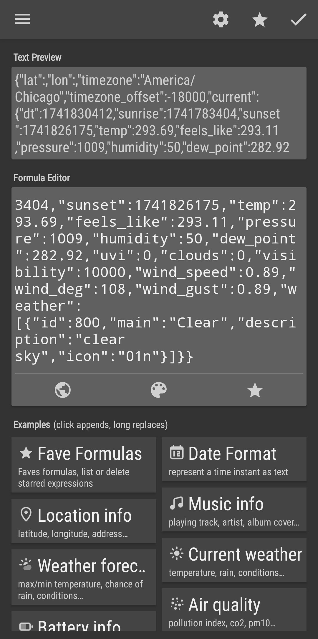

To extract the UVI data, try this code snippet:
Let’s say the API response is stored in a global variable which name is: “weather”.
$tc(json, gv(weather), ".current.uvi")
Please check the JSON response from the API, it might be incorrect.
Here’s an online service for JSON validator & parser.
https://jsonlint.com/

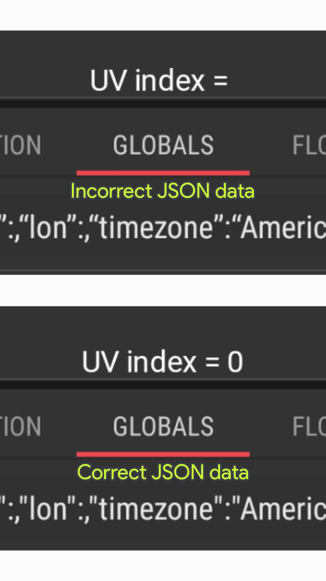

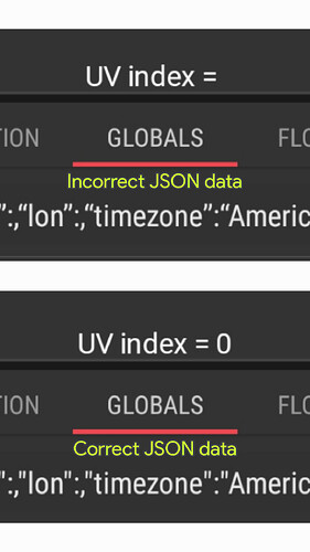

Checked the json response and everything looks great. Thank you for the link. The tc() route is still not pulling anything from the variable tho.

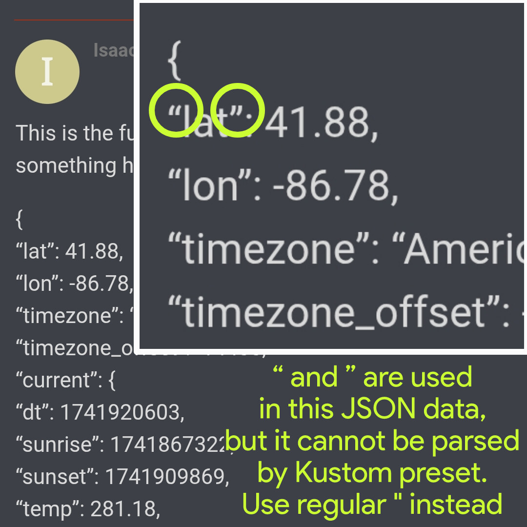

Yesterday when I tried, there was an error in parsing the JSON response. Then I investigated the JSON response and found several incorrect typings.
Search all special character of double quotes and replace them with regular double quotes. ➞ the JSON response you pasted has these “ and ” characters, they’re not parsable because they’re not the regular " character.
Also… there’s a missing } character at the end of the JSON response.

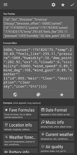

Screenshot 20250314-001 • The global variable
Screenshot 20250314-002 • The code snippet
This is the full json. It works on my end. There’s just something holding up the tc().

Have you checked the “ and ” ? They are both special character that looks like regular double quotes, but they’re unrecognizable by the Kustom preset (by tc() function).
Use the regular/normal " (double quotes) character.
If somehow both “ and ” are set by the API response, you search & replace it (using tc(reg)) before extracting the JSON data.
Here’s my code snippet you can use:
UV index: $
tc(json,
tc(
reg,gv(test),"“|”",tc(utf,22)
),".current.uvi"
