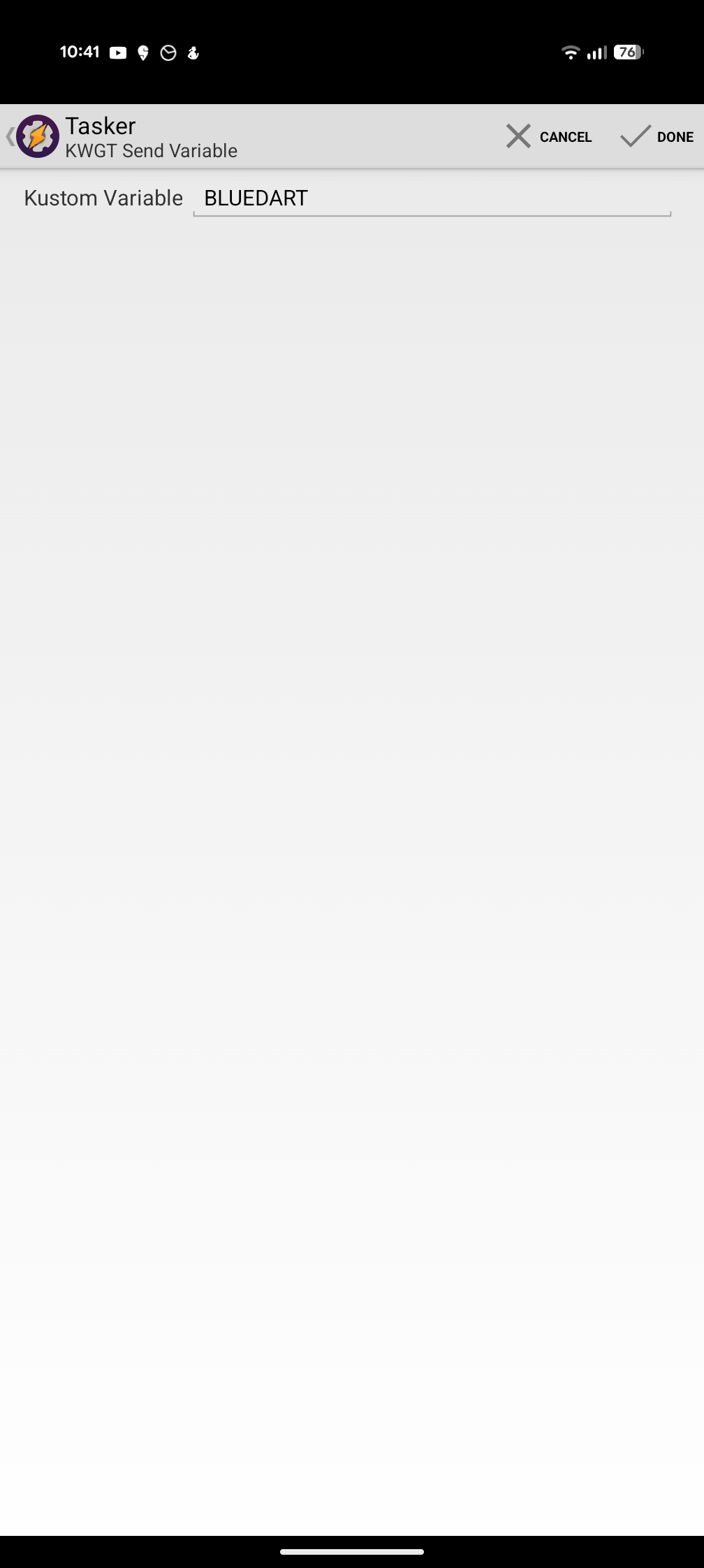

Recently migrated to Google Pixel 9 Pro XL from NP1. After installing all apps and data I was editing a Tasker Action used to send data to a KWGT widget. However the KWGT Send Variable seems to be broken as there is no option to add tasker variable or string. Screenshot attached. Running Android 16 qpr 1 latest beta.

For that to work, one needs two options in Tasker, A Tasker String and a KWGT Variable Name. In SS attached above, there is only one option. There used to be two inputs in there.
Hmm… if there’s no modification made on the KWGT widget, then it might be something changed in the Tasker app.
Perhaps someone else here who knows about Tasker better could help, I am sorry but I do not use Tasker so I could not help you on the Tasker.

SOLVED. the problem is the display size. I was using the smallest display size under Settings> Display. It was pushing the first line beyond display. I was able to access the first line by increasing display size in settings.
