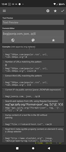

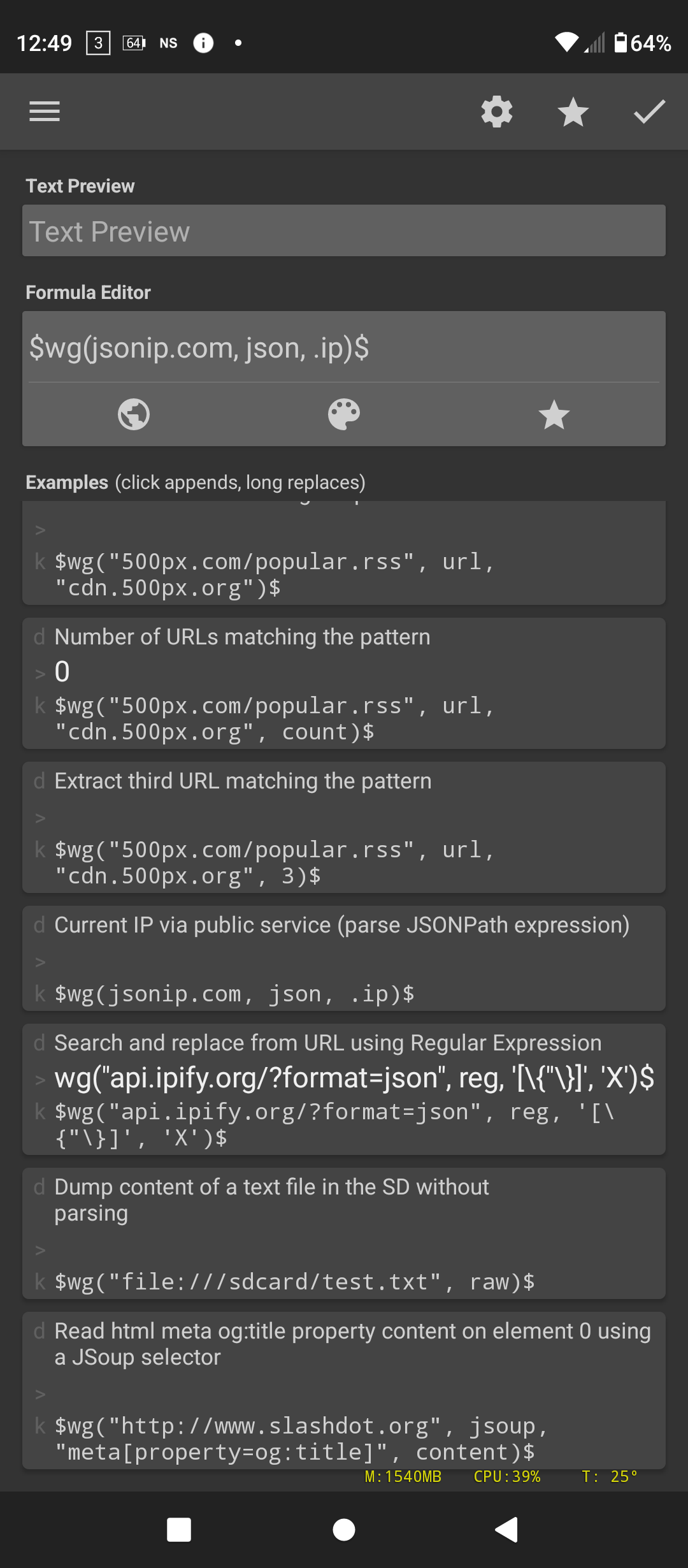

On my Moto XT2215-4, A12, rooted…
The following is the raw data returned from querying my Ecowitt Weather Gateway (http://192.168.1.xx/get_livedata_info). I copy/paste that into the JSON path evaluator here. I am trying to get KLWP to reference the path to a temp sensor that the evaluator says is “$.ch_aisle[0].temp”. So in a text global, I enter this formula: $wg(http://192.168.1.xx/get_livedata_info, json, .ch_aisle[0].temp)$ but the editor shows only an err: unknown in red. What am I doing wrong? Thanks!
