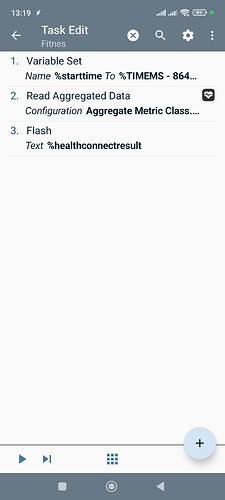

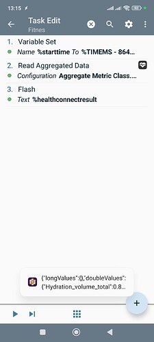

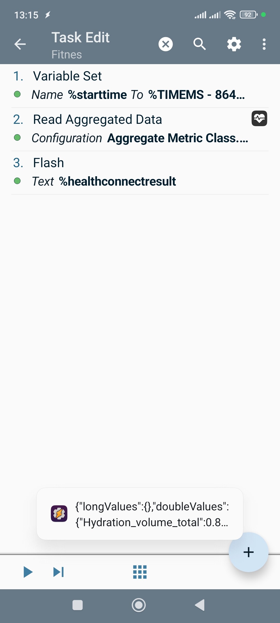

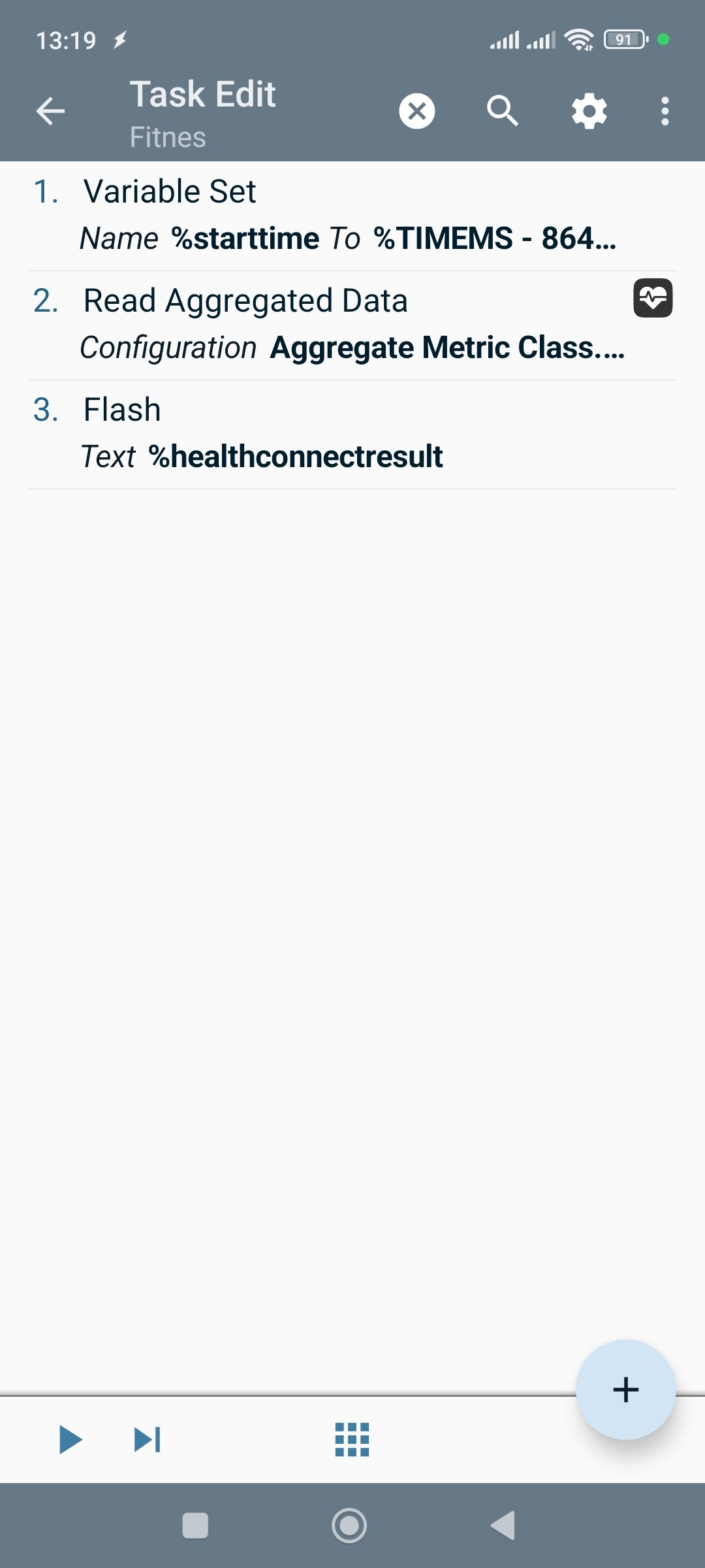

I’ve managed to pull hydration via Tasker + Health Connect Plugin. Here is the logic:
Tasker: Use Variable Set with Do Maths to get a start timestamp (e.g., %TIMEMS - 86400000).
Plugin: Use Read Aggregated Data action.
Metric: HydrationRecord.VOLUME_TOTAL
Start Time: Your variable.
Result: You’ll get a JSON string like {“Hydration_volume_total”:0.8…}. Just parse the value using Variable Search Replace and send it to Kustom via KWGT Send Variable.
