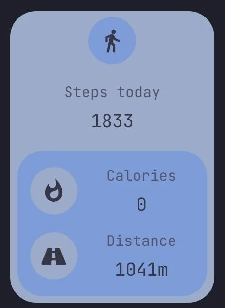

Hi. I’m trying to make a fitness widget on KLWP that tracks your steps, distance traveled, and calories burnt but for some reason the calories tracking remains at 0 while the other stats work fine. I used $fd(cals)$ to display the calories spent. Here are the screenshots of the data that is in Google Fit, and what is displayed on my widget.

Google Fitness integration is unfortunately deprecated, i will migrate to health connect in 3.75, please be patient, you can track the status in this thread
