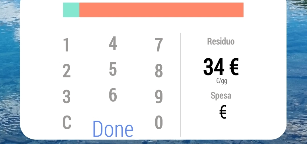

Hi all. I have a widget which i use as a budget tracker. It has worked smoothley till i changed my phone. When imported to the new device it broke. All the functions reading the file underneath no longer worked. The ones that read the file were fixed by changing the path used (from /storage/ emulated/0/Kustom to just /Kustom). But the button “Done” that executes the substraction (with this formula on touch: sh(“echo '” + (wg(“file://storage/emulated/0/Kustom/db/limit.jpg”,raw)-tc(reg,gv(input),“(.)#(.)”,“$1.$2”))+“’ >/storage/emulated/0/Kustom/db/limit.jpg”) ) says Permission Denied. Changing the path does not affect the error.
The widget on the old phone works normally as always. How can I fix it? All the spec are the same (Android version, app version ecc).

Anyway I solved the issue by using Tasker but now I face another issue :smile: : everything works as expected except that the new value is shown only if I enter into the Kustom editor and re-save the widget. How can i automate this? A button with the action to force text update does not work.
