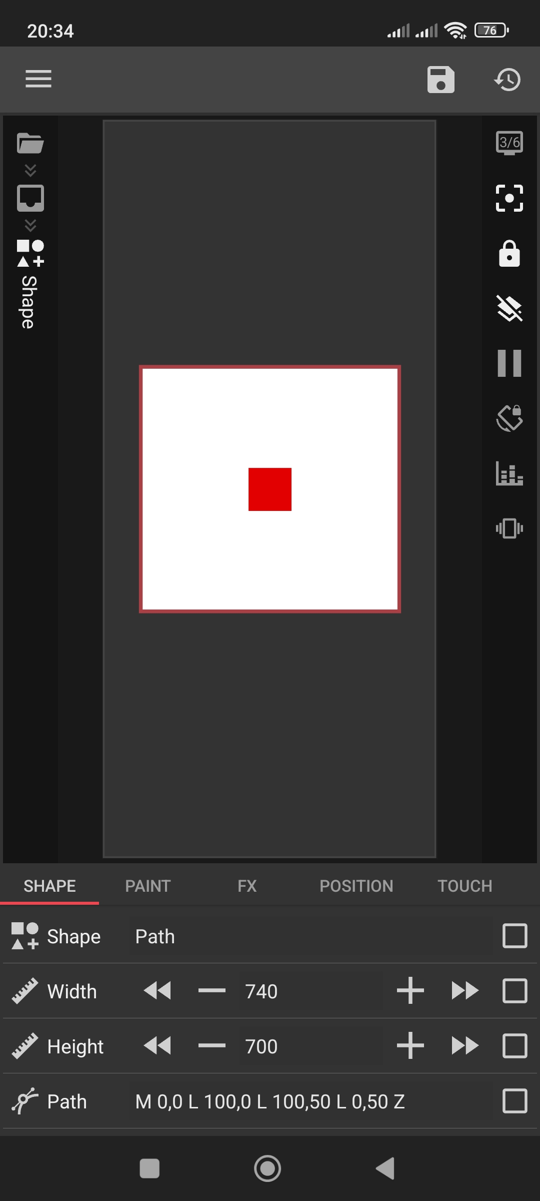

When set the path scale function to “auto (100 x 100), it rendered this:: The Output image
NOTE: i add the square to distinguish between two scale modes.
While on “Fit center”, it gives this output: The Output image
The problem is that the render looks same to what on the Auto (100x100) mode while scale is set to Fit center.

I just tested a simple rectangle path with Fit Center, and it works perfectly on my end.
It’s hard to guess without seeing the actual data. Could you please paste your Path code here? I’ll test it on my end to see exactly what’s causing the shift and check if there are any hidden offsets or bounds issues. It’s the fastest way to fix it.
