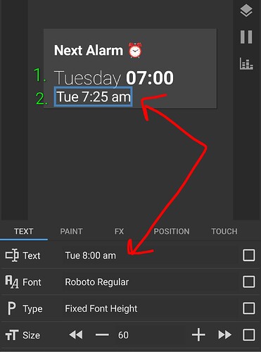

I have a lot of alarms throughout the day and find it useful to know when the next one is which is how I’ve come across this kwgt widget app.
I’m using the stock clock app on my Poco F7 and have a widget on my home page. (2.0.207 Xiaomi HyperOS)
With this code below, why does the next alarm show one hour early?
$if(si(alarmon), df(“hh”, si(alarmd)), not) $:$if(si(alarmon), df(“mm”, si(alarmd)),set)$
I just found another code to use, which interestingly does show the next time correctly (i.e not an hour earlier) however it doesn’t update when I turn an alarm off (which I sometimes need to do) whereas the first code does.
$si(system, next_alarm_clock_formatted) $

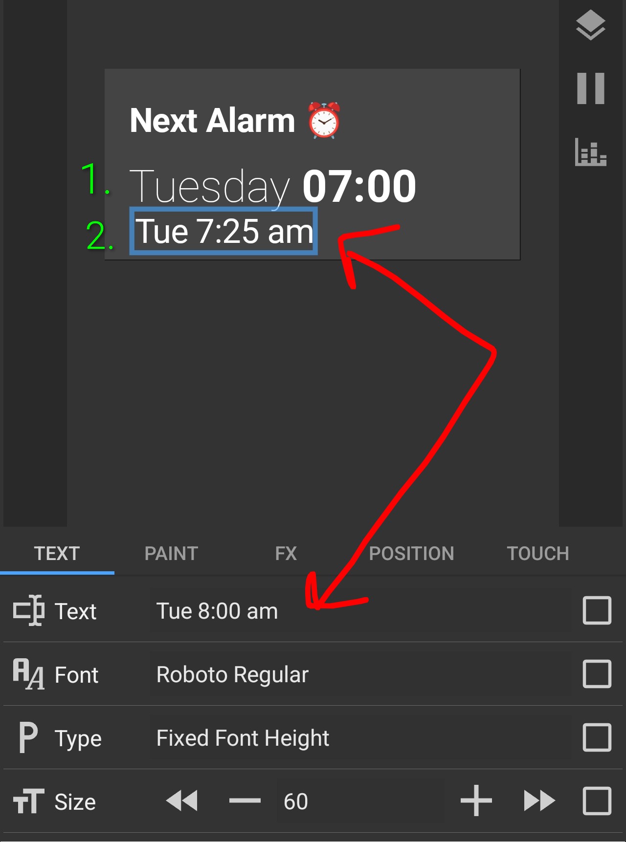

Example: My screenshot attached shows my normal widget: (no.1) showing as next alarm at 7.00am (it’s meant to be 8.00am but is one hour earlier). The bottom line (no 2) is the new code I’ve tried. I had an alarm at 7.25am that I turned off, so it should update to the next alarm which is 8.00am. However in the editor it does show the correct time at the bottom but it displays wrong still being stuck on the alarm time that I’ve now switched off?
I hope this makes sense!
Can anyone help please! :folded_hands:
It’s not useful showing me one hour earlier!
Edit:
The odd thing is if the alarm is in less than an hour, the correct time will show. If it is over an hour, it will show it as an hour earlier
