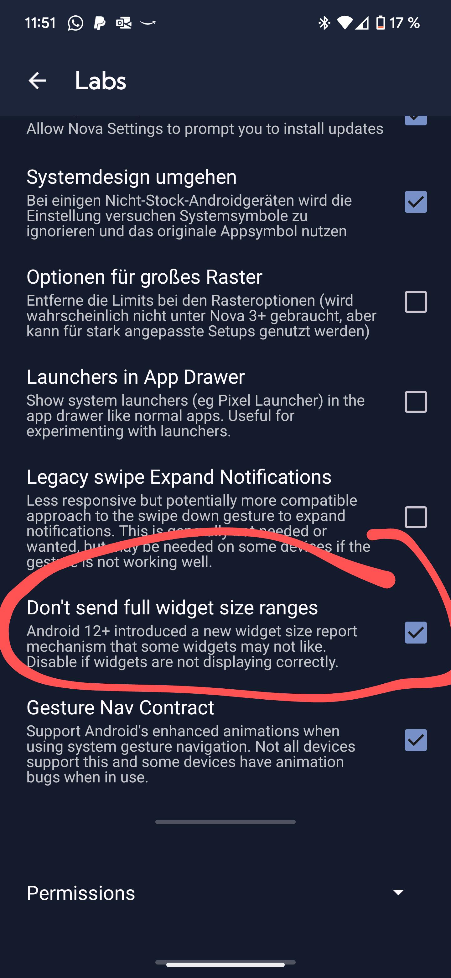

I have also found a workaround. You have to switch the following setting in the Nova Launcher on and off alternately and change the widget size in between. After going back and forth several times, it now works with the setting switched on.
