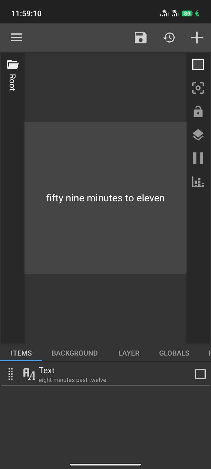

thanks i appreciate your response, but there’s a glitch with your code.
when the time is 11:59 which it should say one minutes to twelve its rather say 59 minutes to eleven
Thank you for noticing the glitch.
I have updated the script with a bug fix to that glitch. Please copy the script and paste it again in the preset (KWGT, KLWP, KLCK).

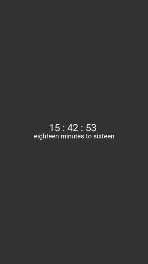

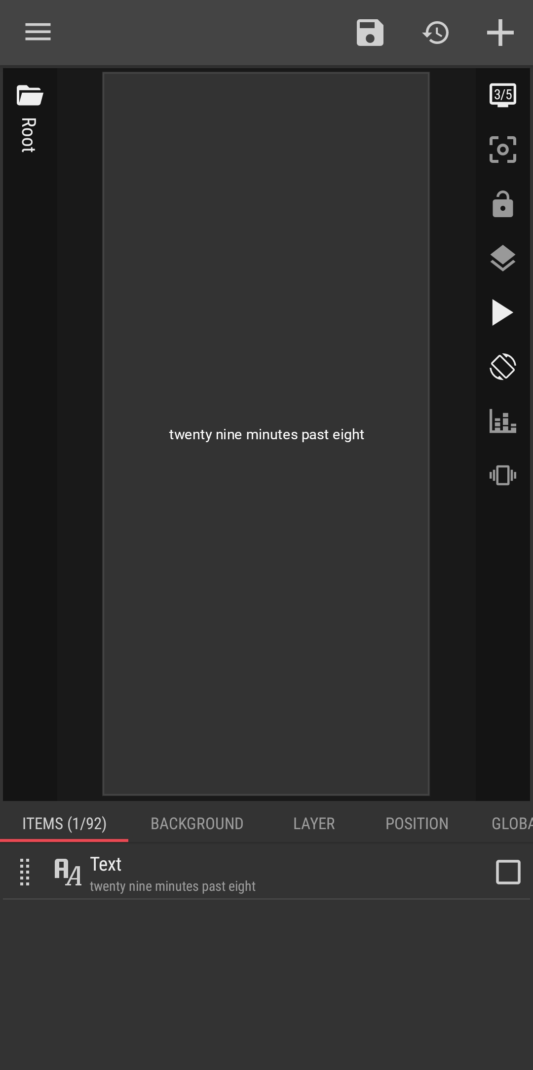

I have updated (again) the script for another glitch. Thanks to @MaxP for noticing and letting me know about it.
Please copy the script and paste it in your preset (KWGT, KLWP, KLCK).
