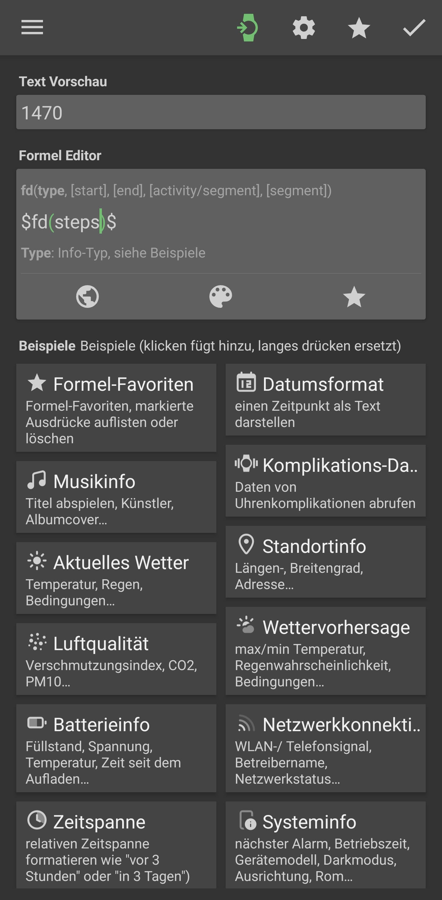

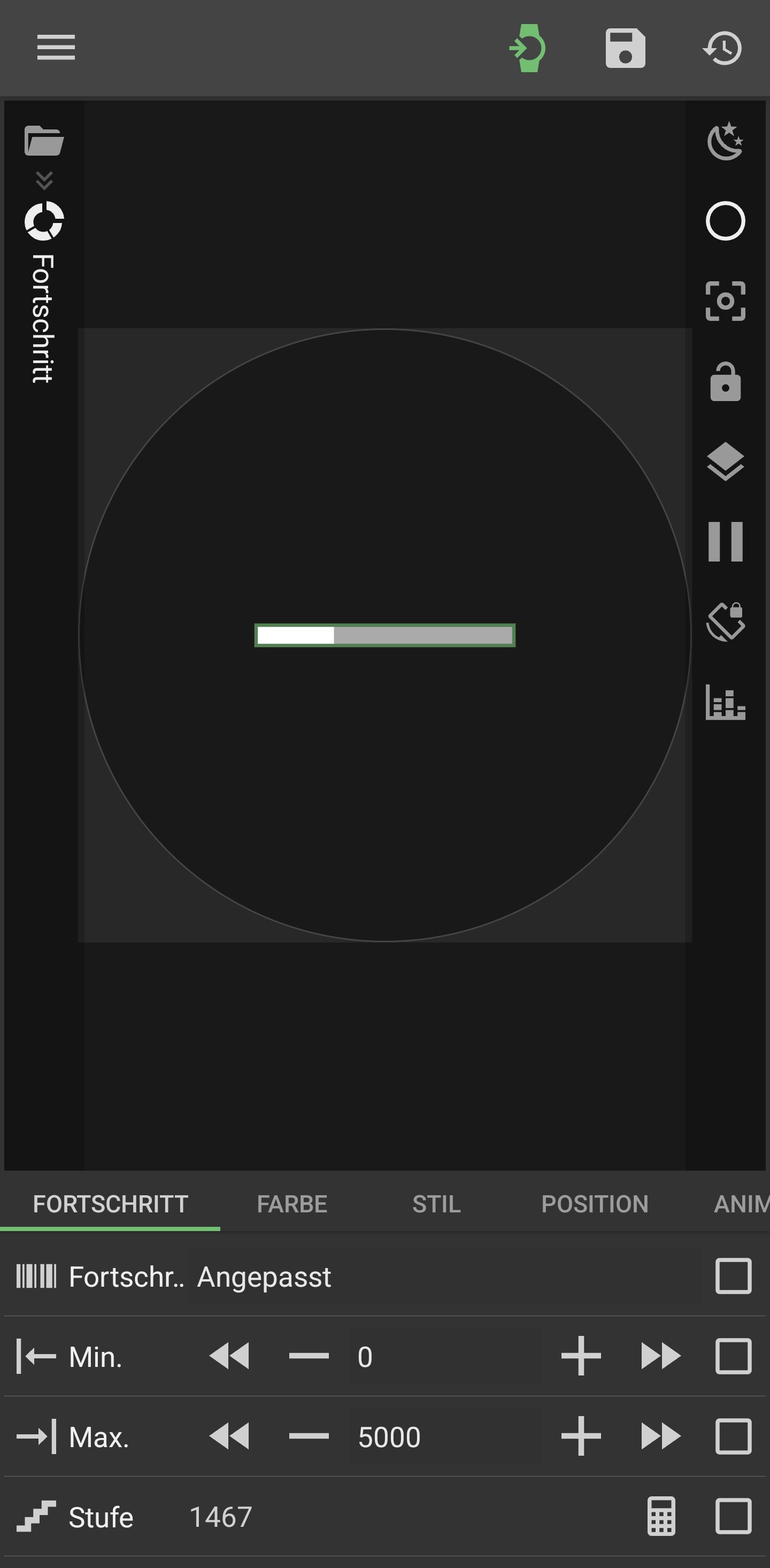

I uploaded a screenshot and the kwch file.
as soon as I move it over to the watch, no circle appears.

As an example: I set a progress bar with the manual values. Level = current steps, Max= 5000 (daily goal) min = 0. What I noticed is that it doesn’t show the current steps, i.e. the level. If I set the progress bar to battery, it does it. As if it can’t currently read the data from steps and display them.
