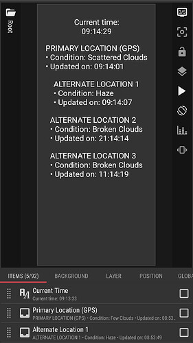

Whenever a Kustom preset (KLWP, KWGT, or KLCK) updates the weather information, it applies to all the four locations (the Primary location and the Alternate 1…3 locations).
AFAIK you cannot clear the location slots.
PREVIEW
In each of the Overlap Group, the Location option (in the Layer tab) is set to an alternate location, this is useful to get the information about the alternate location such as: weather info, latitude & longitude, address, etc.
