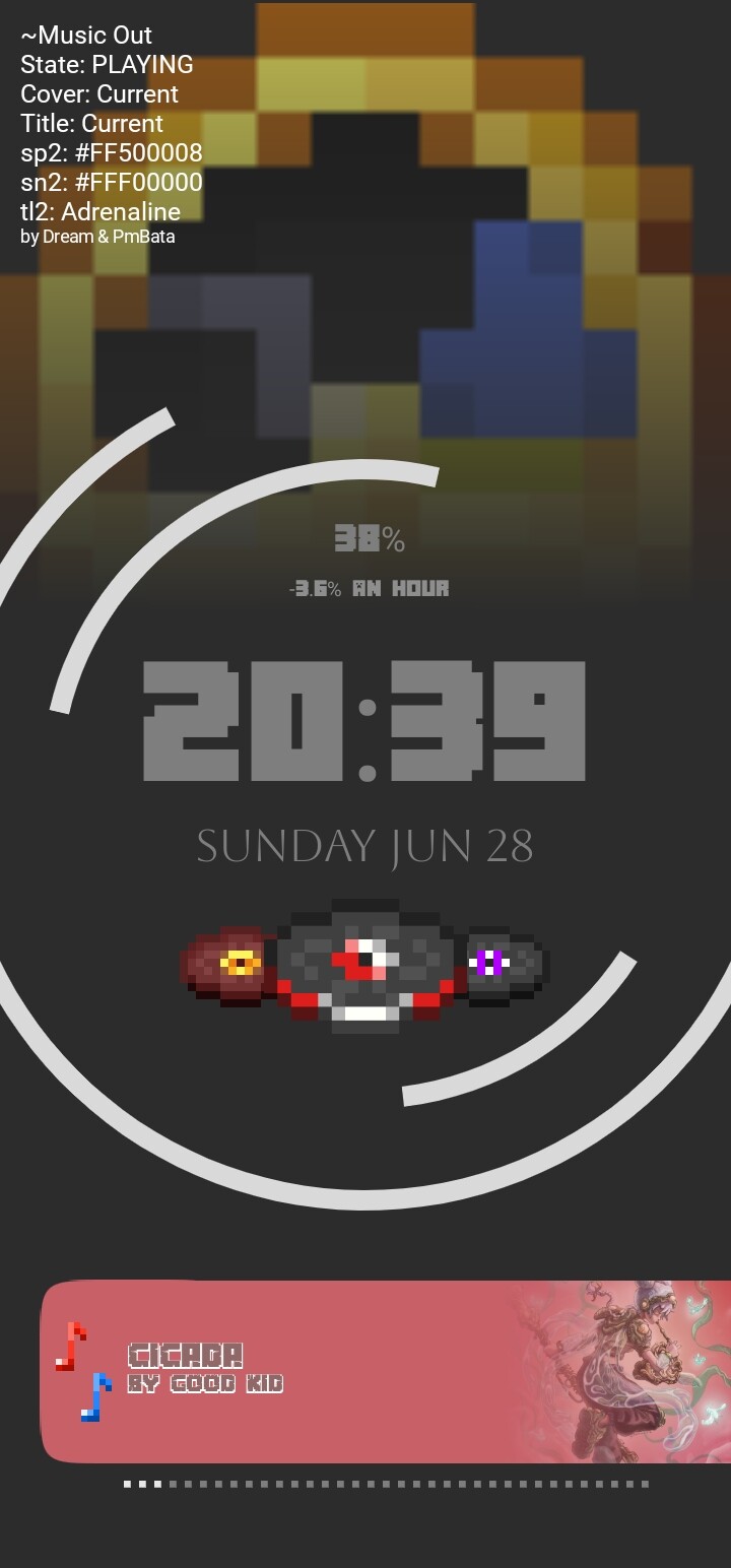

Here the flow work correctly. The title of current music is “Adrenaline” and the gv(tl2)/variable “tl2” is used to remember what title of the last music played. I use this because when the music player is stopped the music info doesnt appear. I do the same for the panel color because I want when the music player was stopped the panel color still appear. The color is based on dominant and vibrant color from the cover. And when the cover is disappear I want the color still. But ..
When I switch the music, sometimes it doesnt update the variable “tl2”. Even though I had the flow and set the trigger based on music title changes.
And.. I think for the formulas I used is all working and when I tested it in editor mode it works correctly. But, when I try for the actual lock screen, sometimes it doesnt work. Idk why. I already changes some setting for global persistence to always overwrite globals. But it doesnt fix the problem. So, is this a bug?
