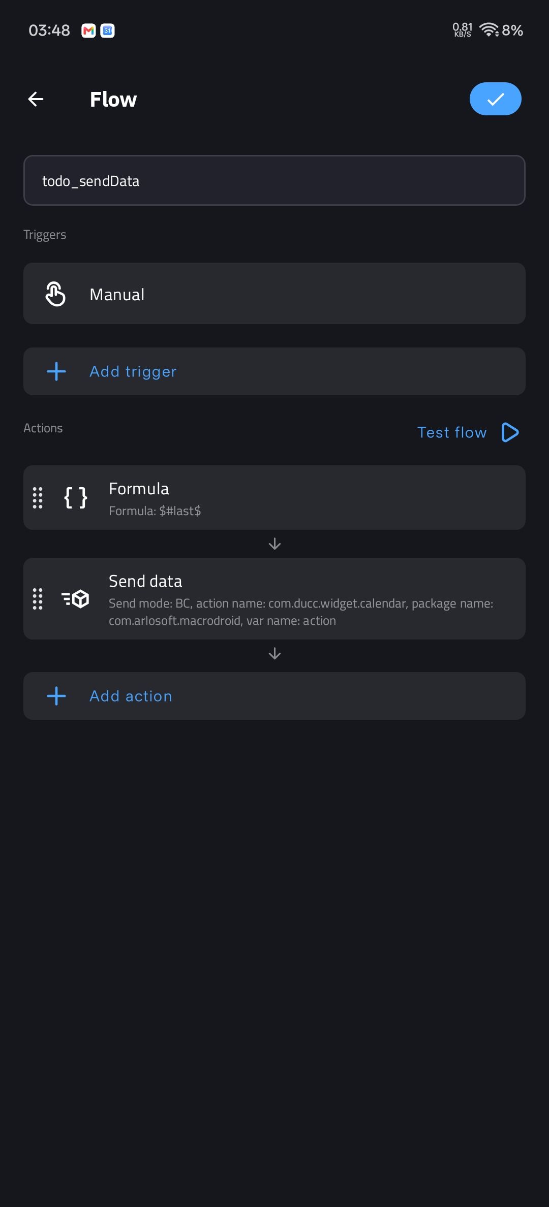

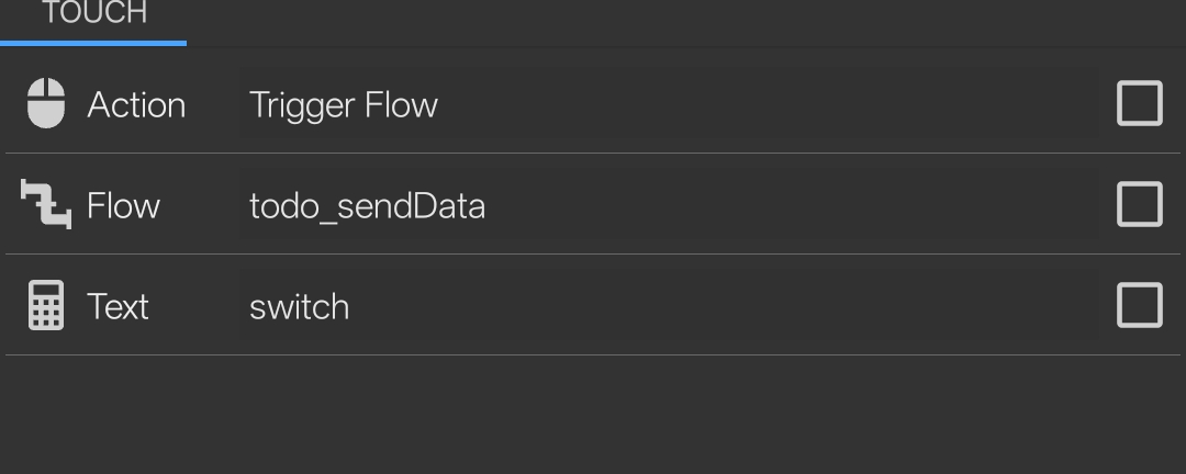

To start/stop your stopwatch but don’t want too much scenes. You can create a flow and pass all your data (actions like start or stop) to tasker (I’m using macrodroid)
And handle them as intent received for your scene and task them accordingly

I have done two versions of the stopwatch, one with macrodroid, one without macrodroid (pure flow)
Tested with OPPO, with macrodroid is more stable (actually updating per second), while pure KWGT aren’t stable (like 4-5 sec update interval, maybe a quirk from using flows as tick)
Here’s all the file (remove .komp for the macrodroid macro to use it)
stopwatch_with_macrodroid.kwgt (303.2 KB)
stopwatch_without_macrodroid.kwgt (303.3 KB)
Stopwatch.macro.komp (28.7 KB)
