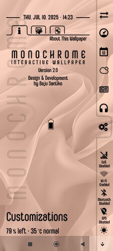

Based on your description & your requirements, try my example .
NOTES
  1. Rename the downloaded file, remove the .zip suffix from the filename.
  2. Move the renamed file (the .kwgt file) to the widgets folder under your Kustom installation folder.
TUTORIAL

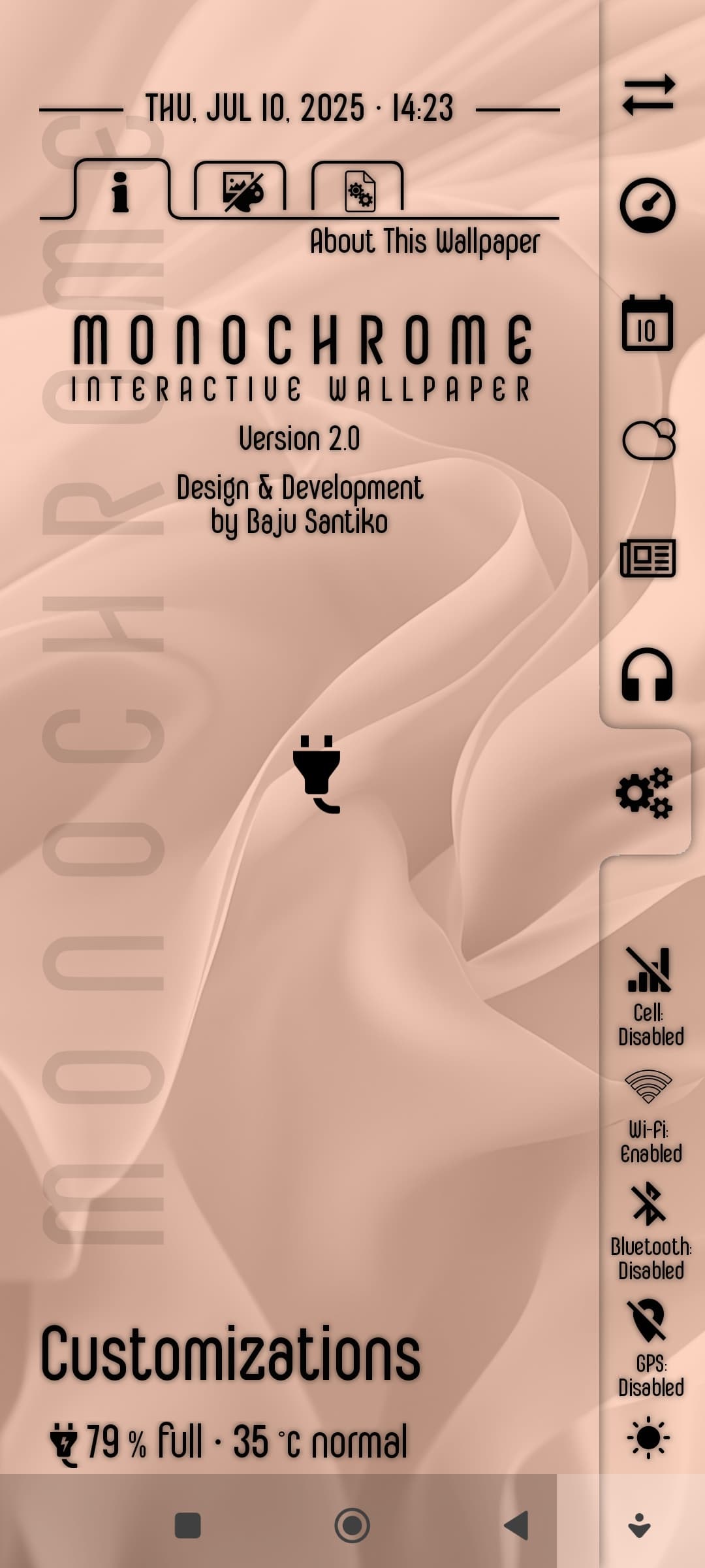

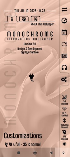

Overlap Group 1, this is for charging (on power) condition.
  • Layer visibility (as formula): $if(bi(charging)=1, Always, Never)$
  • Icon: select a power plug icon

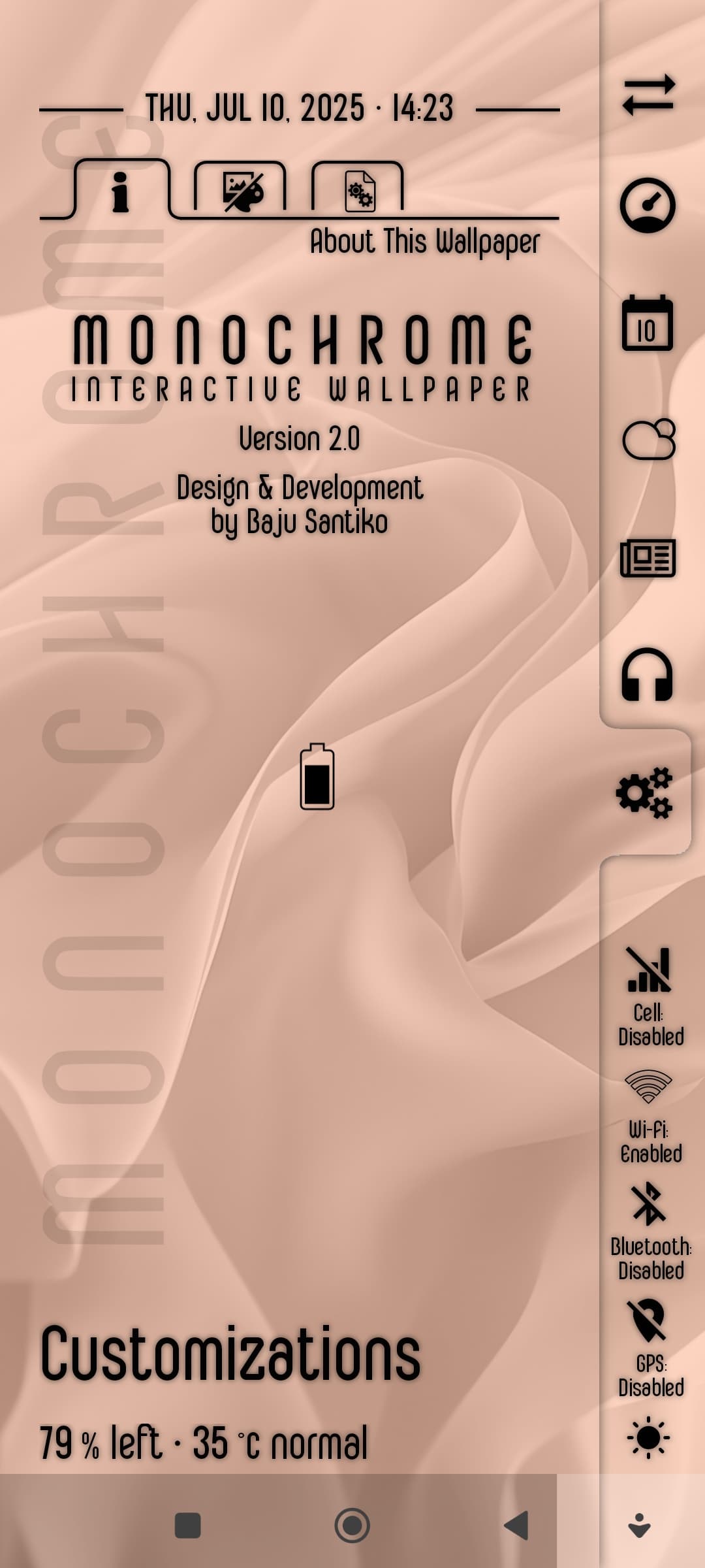

Overlap Group 2, this is for discharging (on battery) condition.
  • Layer visibility (as formula): $if(bi(charging)=0, Always, Never)$
  • Icon: used as the battery outline ➞ select the battery_std and set the paint as stroke
  • Progress: used as the battery juice ➞ ot will show the battery level as a progress bar
