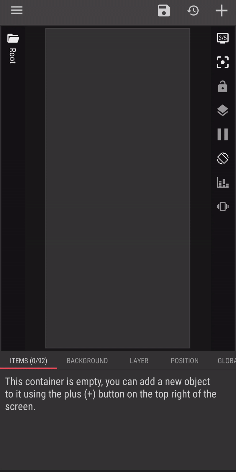

I am currently working on making a wallpaper for my OnePlus open, this is my first time with Android so I am not familiar with what version OS I have but I updated it last night. And I have the pro version of KLWP, https://www.reddit.com/r/kustom/s/pE89LbHXIA.
There is a link to my reddit post that includes a screen recording of the issue I’m having. I’m editing a current wallpaper so I don’t know if that’s the issue? But the wall paper also gets like that staticy look when I unfold my phone and then fold it back again
Have you tried to activate this setting in your KLWP?
Disable Parallel Rendering
