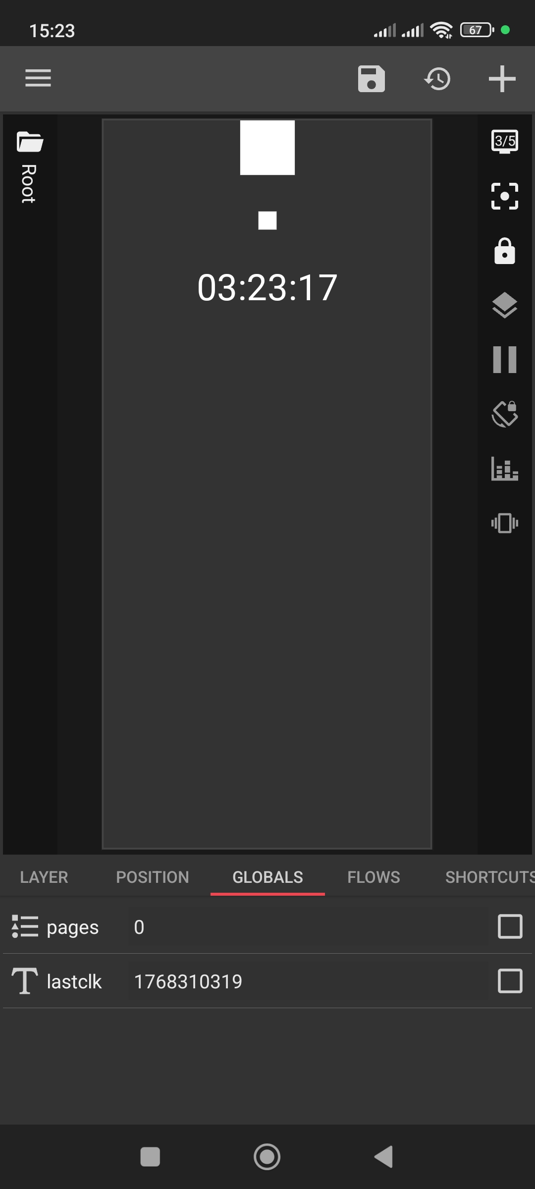

  1. ​Global Vars: pages (List 0,1) and lastclk (Text).
  2. ​Manual Button (Touch): Set pages to toggle AND set lastclk to $df(S)$.

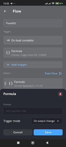

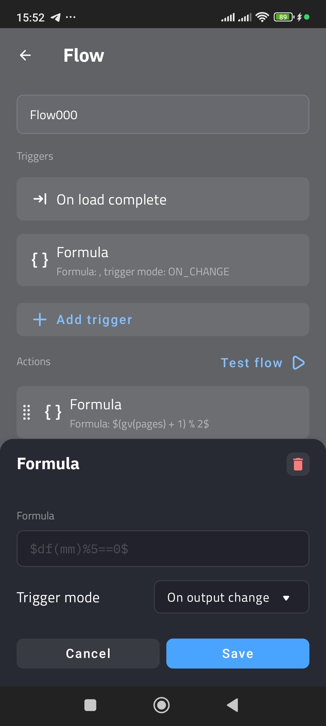

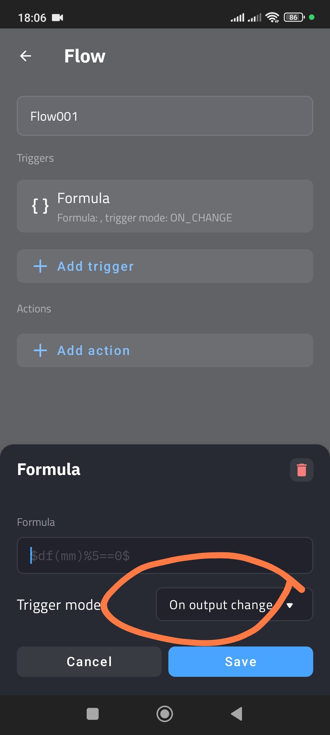

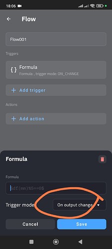

Where is “Output Change”? Go to Flow → Trigger → Formula. To the right of the formula box( see screen).
The Catch: You can set this up in KWGT, and it will work perfectly inside the editor. However, on your home screen, it will fail.
Why: Android limits widget updates to save battery (usually once per minute max). This is why I recommended KLWP — only live wallpapers can handle 10-second loops reliably.
I don’t have this. In formula I have only the textbox to write the formula and the Cancel/Save buttons.

Instead of using a 10‑second interval, you can simply switch to a 1‑minute interval and let the system clock handle the trigger.
- Trigger: formula → $df(mm)$
- Mode: On output change
- Effect: every time the minute changes, the flow triggers and flips your page automatically.
Ok, I finally found it! The “formula” list item of the flow trigger is covered from my device’s bottom bar with the buttons for back/homescreen/recent apps. For this I couldn’t see it. Now I can proceed.
So, now I have:
  • 2 globals, one list with name pages and 0,1 as list items, and one text with no content

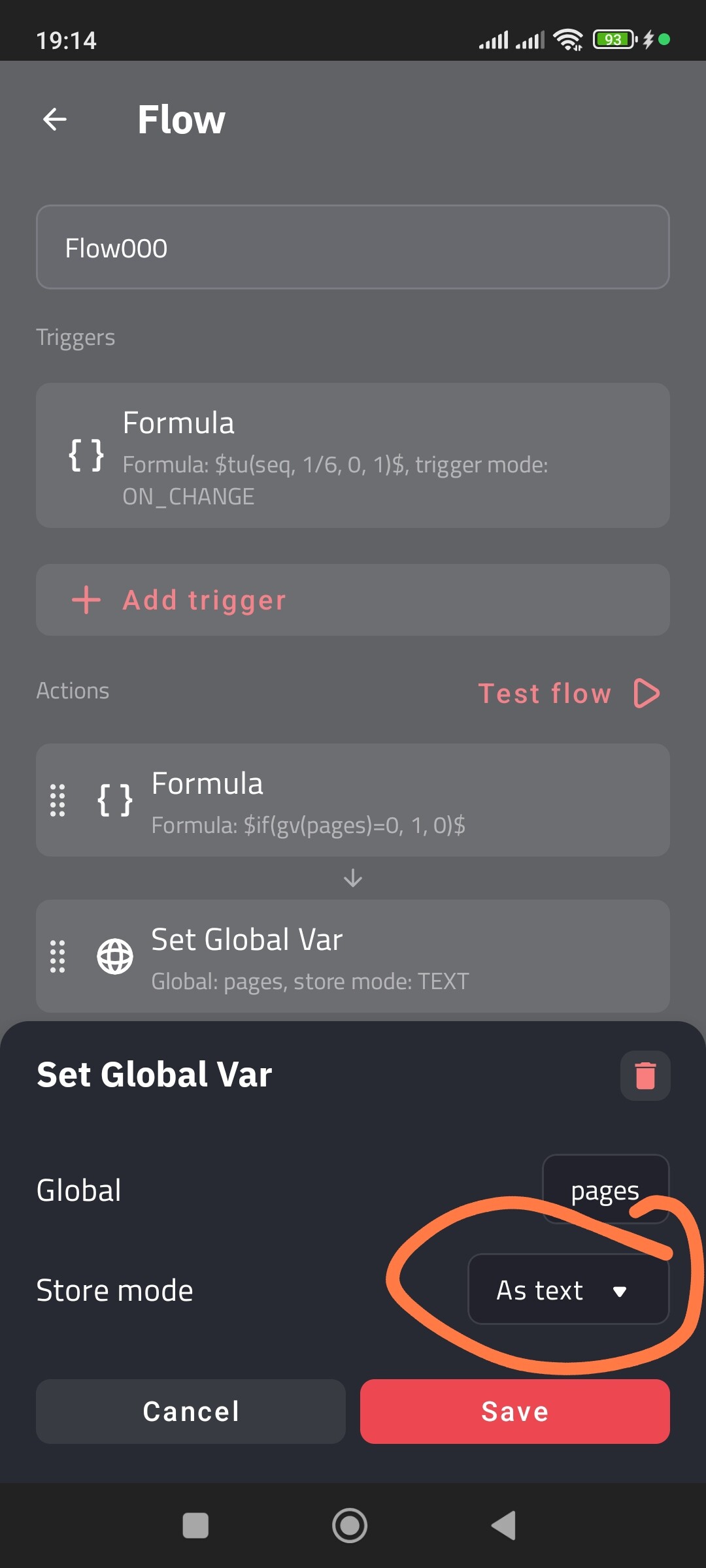

I see from your images that you have also another action “Set Global Var” which I suppose I need to also add it and use the global text variable I defined.

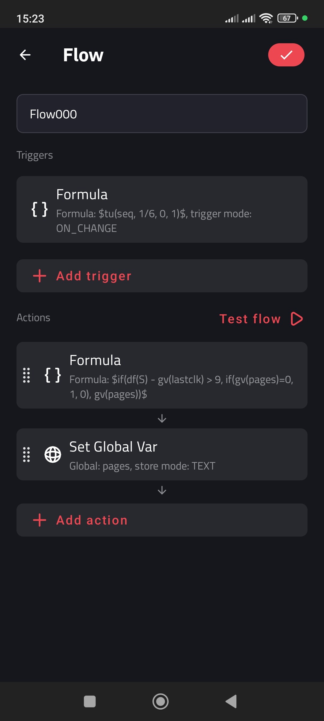

​The Flow Action:
​In your Flow, Action 1 (Formula) calculates the value.
​You MUST add Action 2: Set Global Var.
​In Action 2, select your global pages as text. This tells the Flow to actually save the result of the formula into your variable.

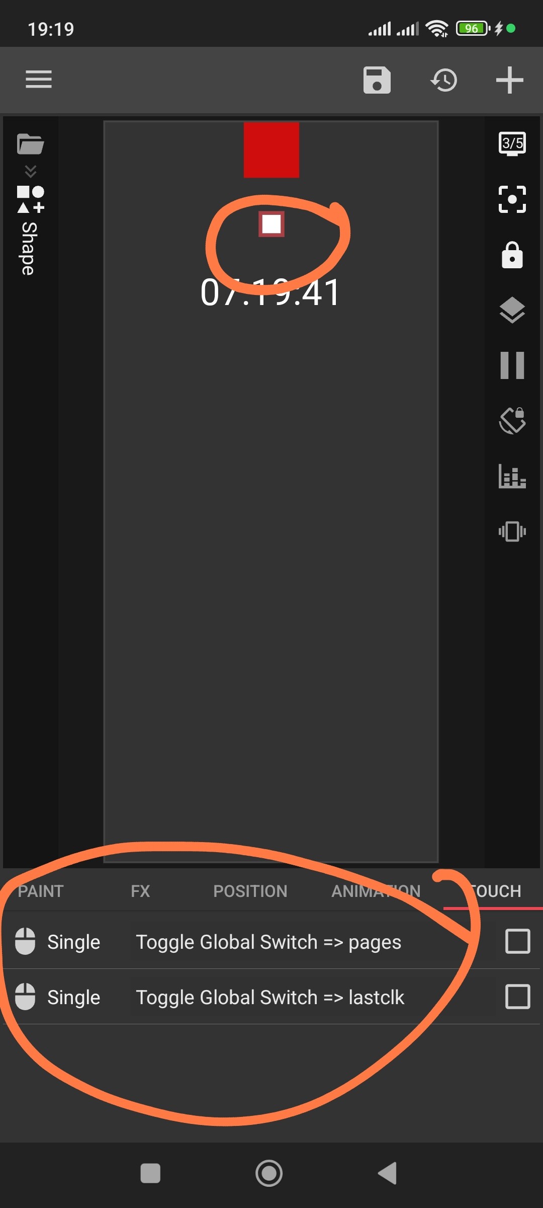

​The “Manual” Button (Very Important):
​Your button touch needs two actions now.
​Action 1: Toggle Global Switch → pages.
​Action 2: Set Global Var → lastclk with the formula $df(S)$.(You can make this button invisible and place it directly on top of your layers.)
​Without this, the timer won’t know you clicked the button manually.

It’s done but it doesn’t work. I can change the overlays with the Toggle button, but the timer doesn’t seems to work even in the editor. I don’t see any difference from the images except the action formula. On your first answer was
$if(df(S) - gv(lastclk) > 9, if(gv(pages)=0, 1, 0), gv(pages))$ (I’m using this),
in image is if(gv(pages)=0,1,0)$
which I don’t think that is all the formula.

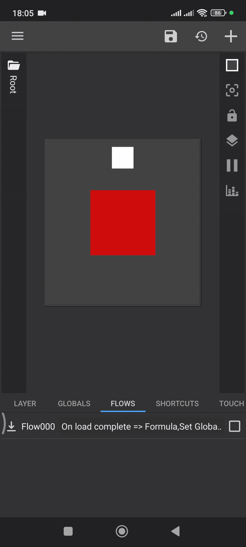

I made a sample file for you to test. Check the link/attachment.

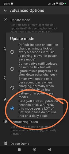

To make it work every 10 seconds on your home screen like it does for me, you need to enable a hidden setting (Warning: this will drain more battery):
Open KWGT Settings.
Go to Advanced Options.
Find Update Mode and set it to “Fast (will always update on seconds tick)”.

The Flow: It now has two actions. The first calculates the page, and the second saves it to your pages global.
The Trigger: I set it to a faster formula so you can see it working immediately.
The Button: It updates the lastclk variable so the timer doesn’t conflict with your manual clicks.

10_sec_fast_test.kwgt (94.8 KB)
Thanks, this file works, and the problem is that I was using the formula from your first answer in flow action and not this: $if(gv(pages)=0,1,0)$.
