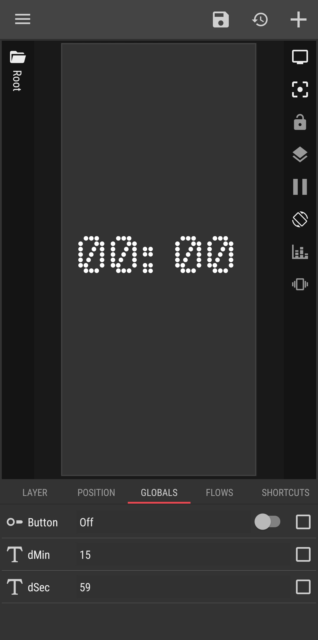

Here’s an example of the Kustom script for a timer functionality.
- Create a global variable for the trigger switch, name it:
Button
- Create a global variable for the starting minute. Name it
dMin and set its value to a minute number (ie. 15)
- Create a global variable for the starting second. Name it
dSec and set its value to 59.
- Create a Text element and set its value to the Kustom script below.
- Add a touch action to the Text element, select Toggle Global Switch action type, then select the Button variable from the selection.
KUSTOM SCRIPT

PREVIEW
Timer Preview
