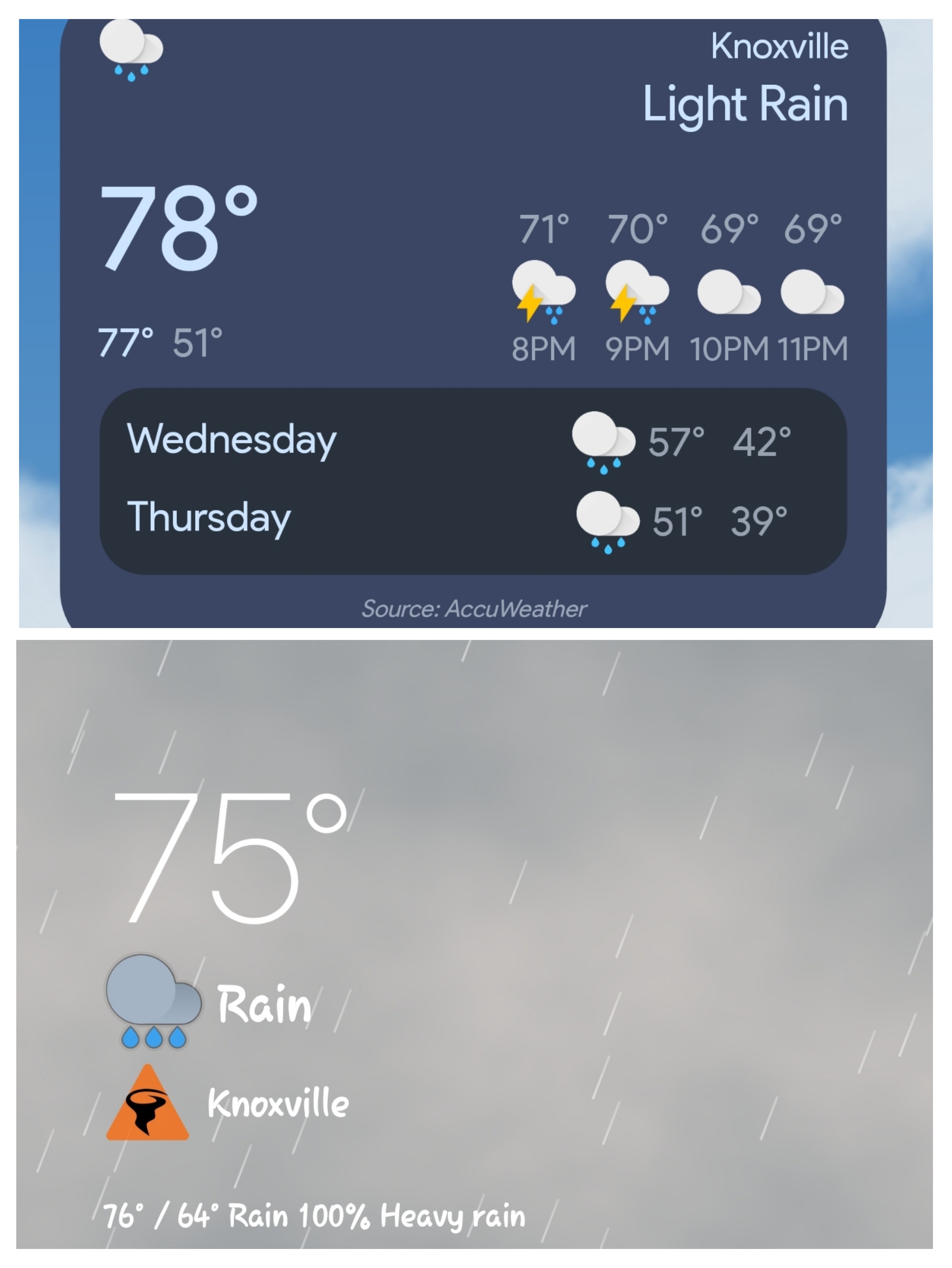

Does anyone know how I can add a severe weather icon similar to one as in the second screenshot? Example yellow exclamation triangle for advisories, orange for watches and red for warnings?

What about for other weather events such as advisories, watches or warnings?
Pretty sure that’s not possible to get advisory/watches like heat or tornado or hurricanes nor does warnings. Is the second picture actually of kwgt widget? But I’m pretty sure we can get warning throught wg function so that’s option if you really want that icon ha ha :joy: :wink:
The second one no, that is a 3rd party app
I think you can do it if you sign up for a free account at Openweather then you can use Tasker and the API to pull JSON info with the data you want. Then you’d have to broadcast it to Kustom and add whatever icons you want to appear with that data.
yep, definitely could be done, or maybe pull data from API Web Service (weather.gov)] it doesn’t require Api but not sure about how often it is up to date and pretty sure that’s limited to around North America so openweather might be best choice. weather.gov also has easy access endpoint that is going(after june 20th of this year) to be in-place Endpoint-alerts-changes-scn24-55_api_v1.13.pdf (weather.gov)
