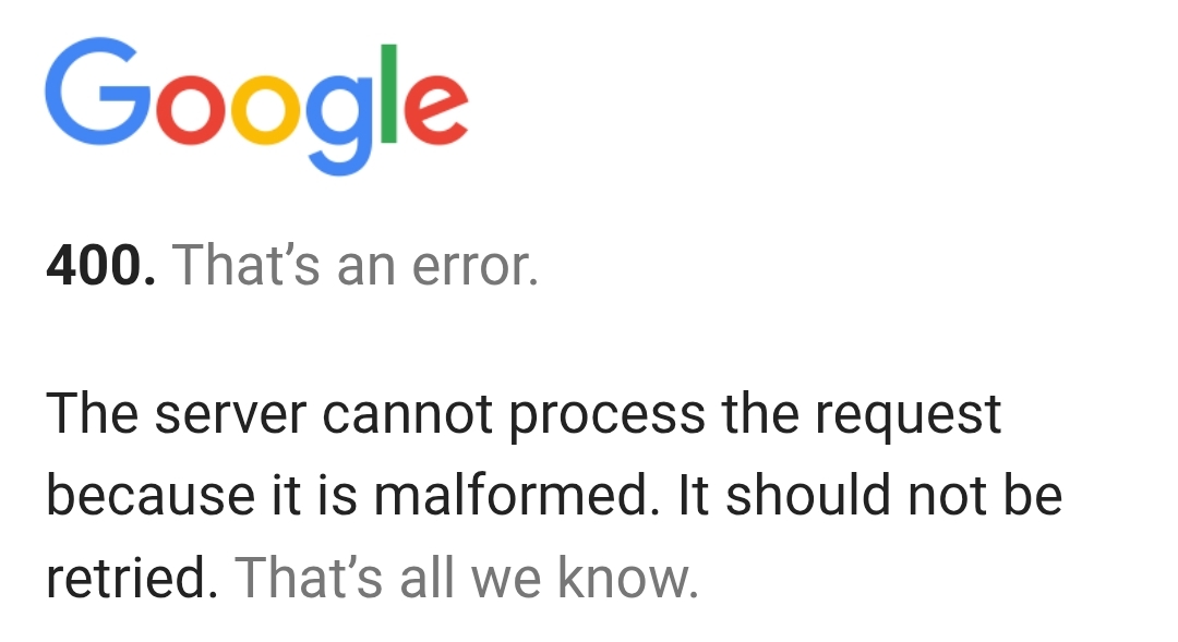

The Google Drive link cannot be accessed.

You shared the link to sign in to Google Account, not the link to the file.
