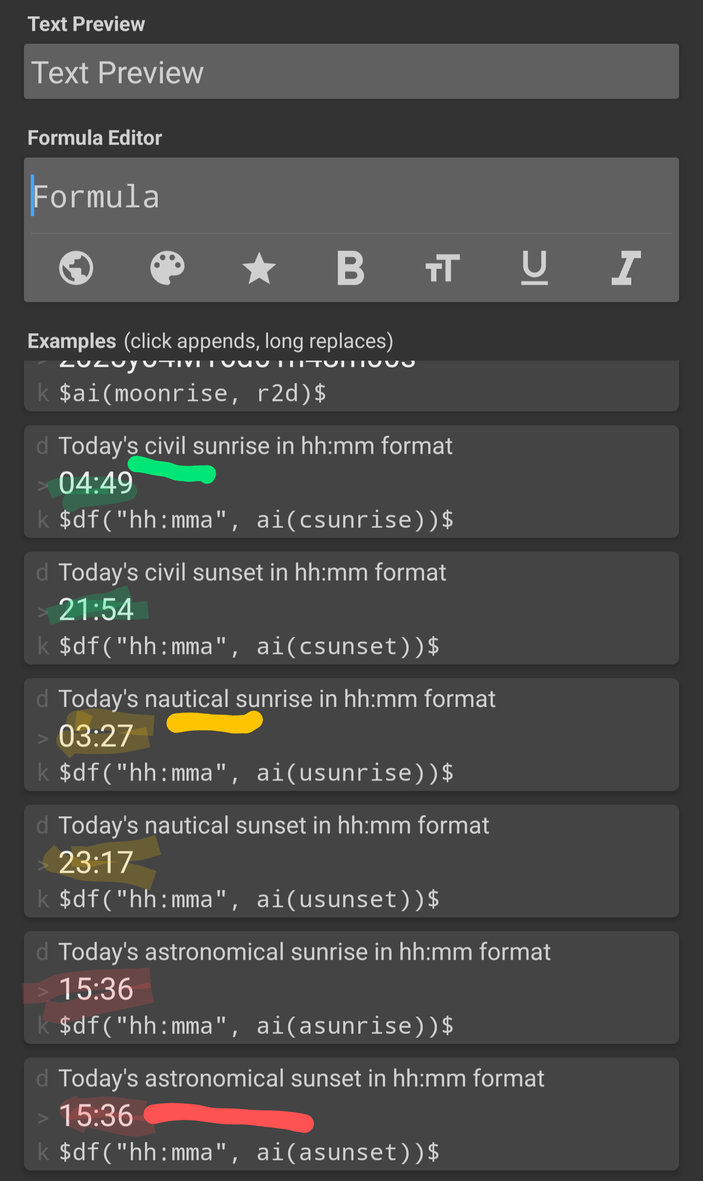

I’ve been struggling with my sundial widget recently, and I’ve finally found out that the values for astronomical sunrise and sunset are wrong. It worked until some days ago. Is this a bug, or am I missing a setting somewhere?
Here’s the values I receive:

What versions of things are you using? It’s hard to troubleshoot without that. I’m guessing that you’re using one of the KLWP 3.78 beta versions, and possibly updated recently. 3.77 and the stable version of 3.78 both give the correct results. (I may have already replied on Reddit).
Ah, my version is 3.77 beta (“Version 3.77b435216”) of KWGT. I had a similar issue last year when winter came. I’m from the north though, so maybe that interfere with the calculations on the back end?
Well there’s a 3.78 that is a stable release and about six 3.78 betas, so you probably want to try updating and see if that solves it.
