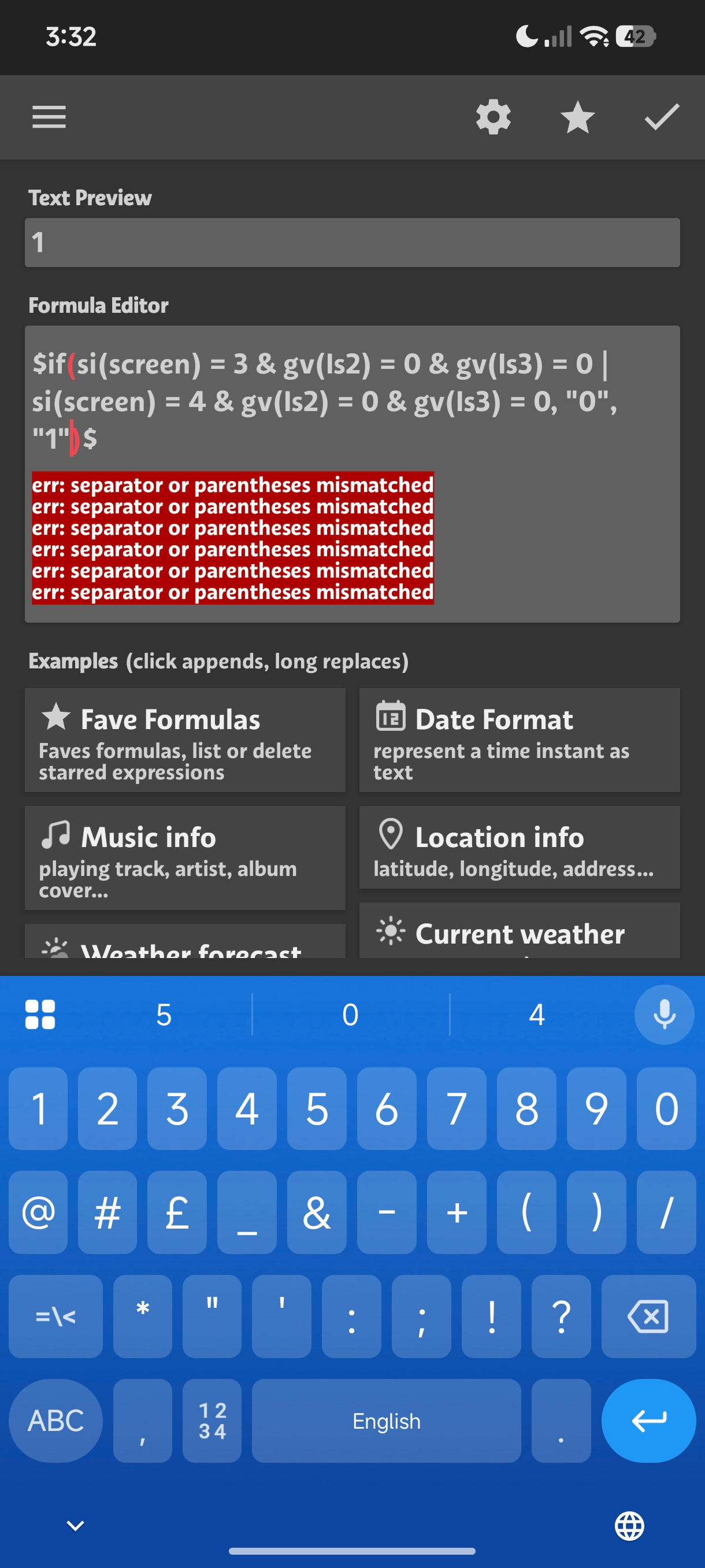

i am trying to add fade transitions to 3 different wallpapers for when i scroll to different home pages, but none are showing up and i don’t see any problems in the code i entered to make the toggles work
am i doing anything wrong? and is there a much simpler workaround that i don’t know about
if it is a code related problem that i’m doing wrong, it is likely that i am not familiar with kustom formulas as i am only familiar to roblox lua code
operating system: hyperos 3.0.5.0
device: xiaomi poco x7 pro
launcher: poco launcher
klwp version: 3.81
Your main issue is a syntax error: you have an extra closing parenthesis ) at the very end of your formula, and you need to group your OR conditions.
Try this:
$if((si(screen)=3 | si(screen)=4) & gv(ls2)=0 & gv(ls3)=0, 0, 1)$
