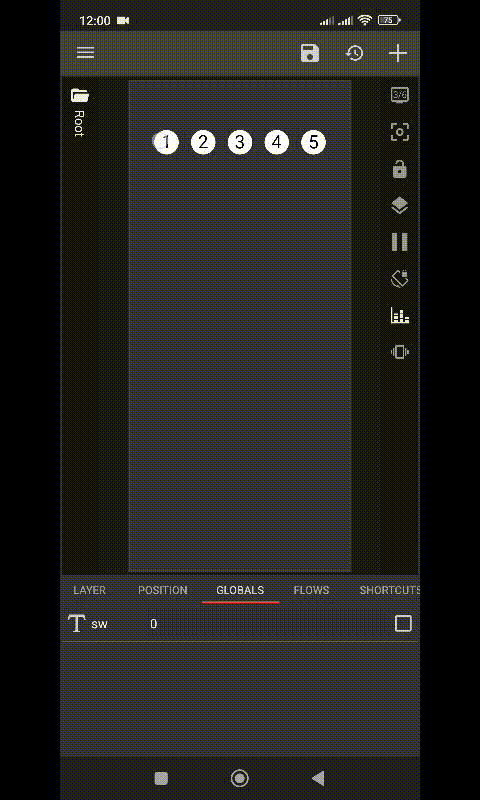

Hi @Baju_Santiko, I slightly reworked your animation so that tapping the button again closes the element — just like @garugc wanted, if I understood him correctly. This version might be useful as well.
Screenrecorder-2026-07-03-12-00-19-295

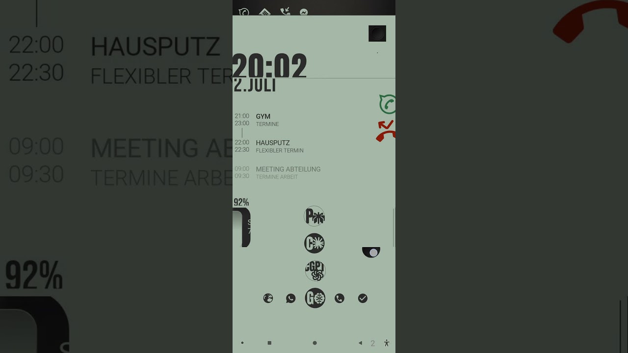

Eureka! I figured it out, and it’s so simple:
In the video, you can see me pressing the individual buttons; the elements open and close each other. After 5 seconds, the elements close on their own. Since my theme allows for a color change, I tapped that button a few times just for fun.
The solution:
1. Create a global text variable.
This contains the element number plus a timestamp (to close automaticaly after 5 seconds). For example, element1 has the entry “1, 171982345.” Button2 overwrites the entry with “2, 171982350.”
2. Button1, for example, gets this touch variable:
1,$df(S) + 5$
(current second + 5 seconds)
3. Animation using the following formula:
$if(tc(split, gv(gvName), “,”, 0) = 1 & df(S) < tc(split, gv(gvName), “,”, 1), 1, 0)$
This checks the following:
1. Is my own number at the beginning of the variable?
2. Is the current system time still less than the timestamp after the decimal point?
