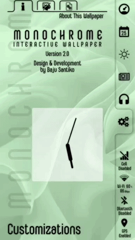

I tried to create a simple clock widget using the latest version of KWGT. It looks fine, no lag/delay in the clock’s Second arm movement ONLY if the Update Mode is set to every second (with the cost of battery juice).
Below is an animated GIF image showing the effects of the Update Mode setting in KWGT.
Simple Clock Widget • KWGT
So, I think there’s something that cause your issue, either one of those that was explained by @MaxP above.
It actually works with the lowest update setting (the one that consumes more battery).
Problem solved—thanks everyone.
