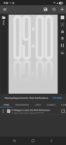

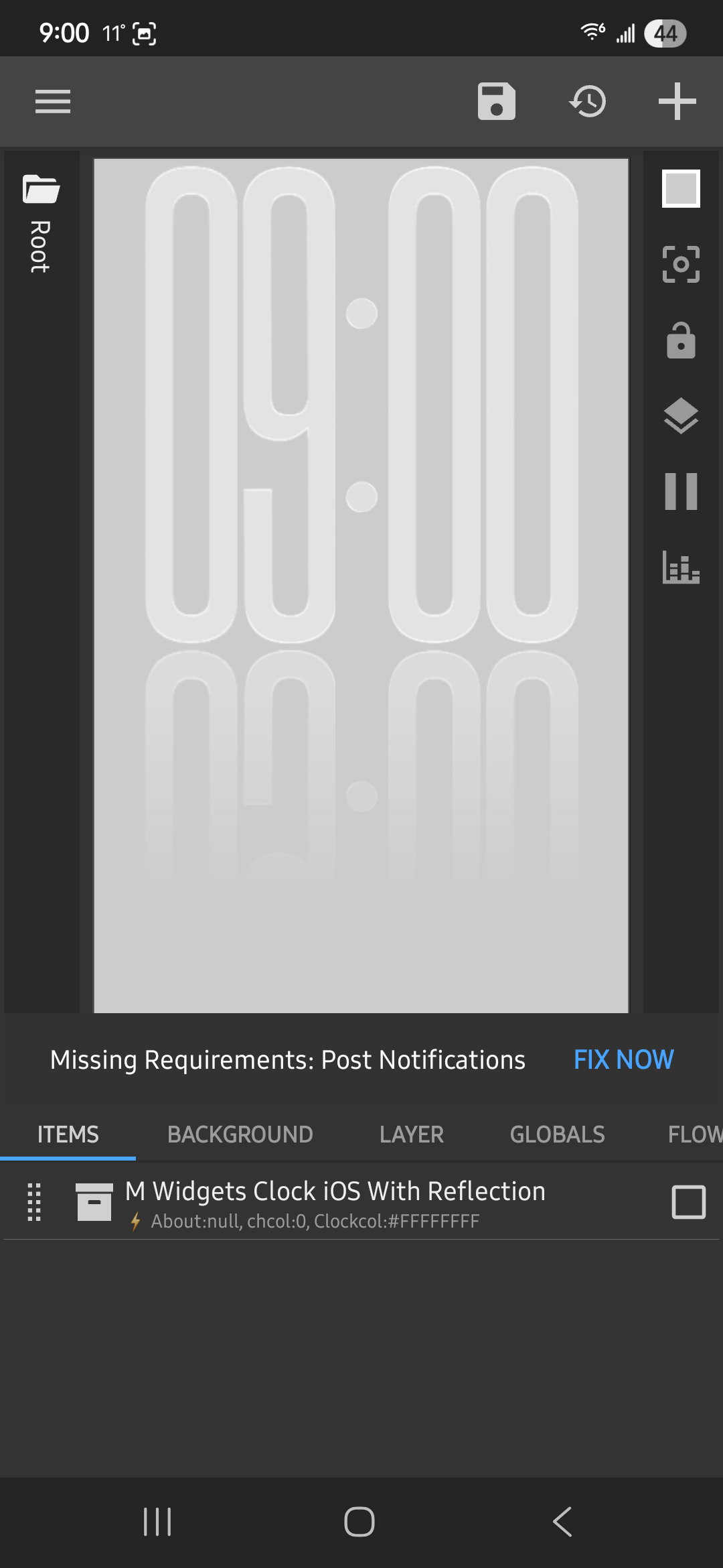

Thx, actually, I don’t see the text element, see attached.
Oh wow, it’s really nice to see people using my komponents on their screens!:+1:
This komponent is made from images, not text, so unfortunately you can’t modify it yourself.
I added the leading zero on purpose to keep the clock design proportional.
I might create a version without the leading zero when I have time.
If you’re interested, keep an eye on updates in my Telegram — the link is in my profile
