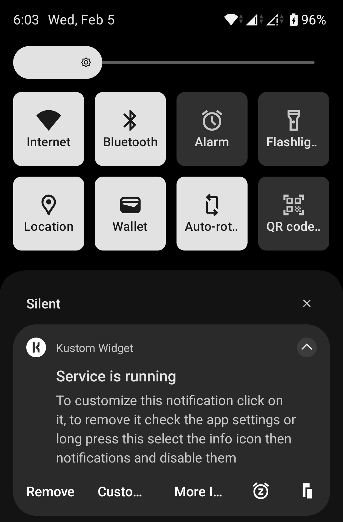

Even with the KWGT silent notification clearly present in the notification pulldown area, KWGT widgets still continue to enter extended periods of non-update. I just observed an almost 1-hour-long lag of the KWGT square-clock widget, even though the KWGT notification was running.
There’s no third-party “battery optimization” software of any kind on the phone (and there’s never been). And the Android app settings are set to allow background battery usage by KWGT. So, battery-wise, KWGT is enabled everywhere.

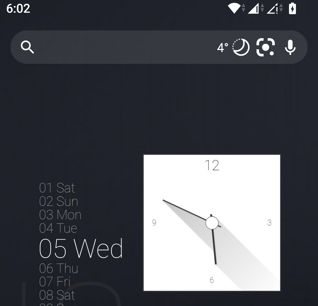

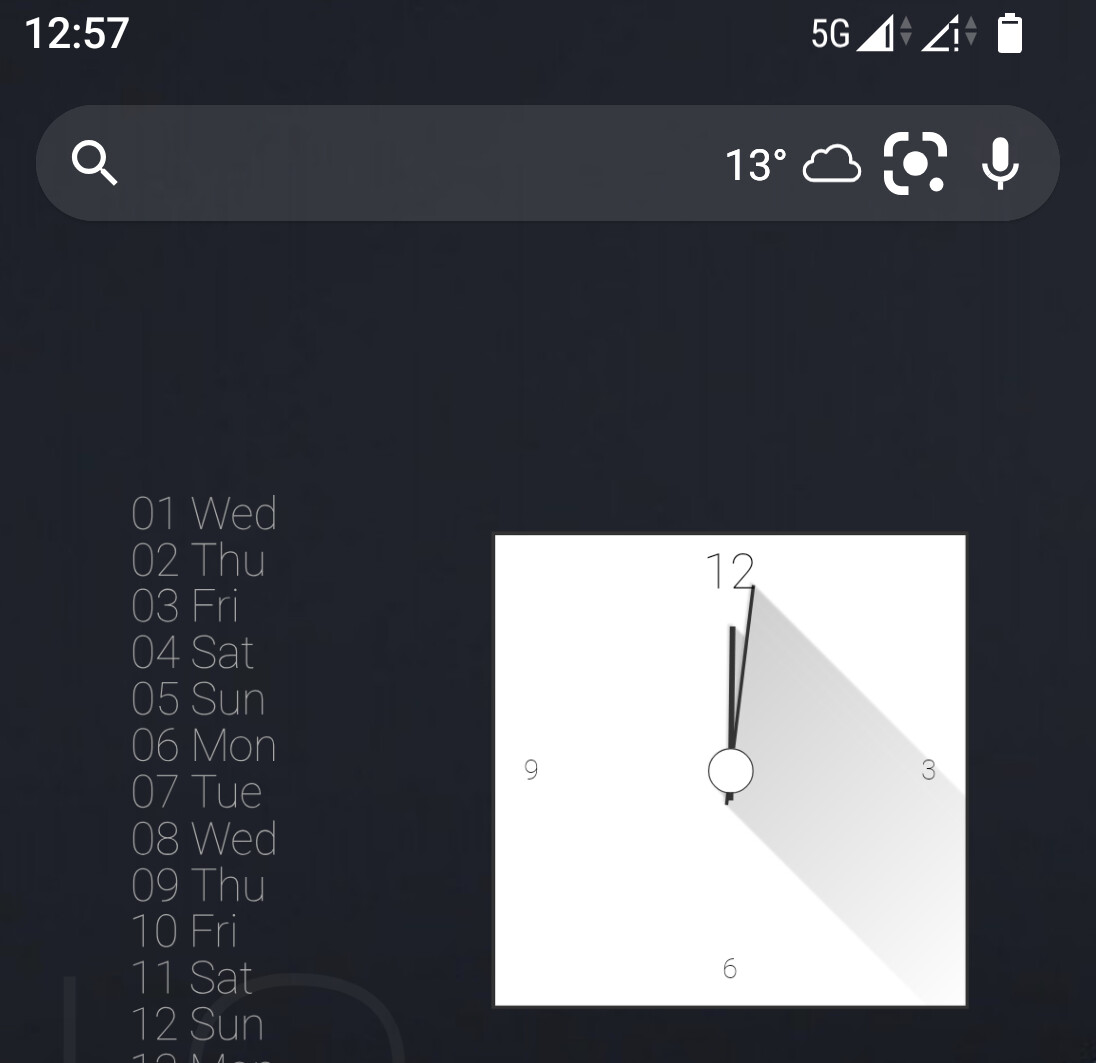

Even after manual update (by starting the KWGT app) the widgets are still stuck. Here it is:

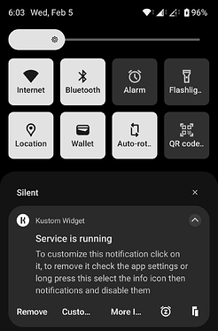

The notification is present loud-and-clear, claiming that “Service is running”

Basically, the current version of KWGT is inoperational under Android 15. Hopefully, it will get updated for Android 15. Otherwise, Android 14 is apparently the end-of-life for KWGT.
P.S. It is not 9:00 AM, but the KWGT square clock is still frozen in the same position. And the notification is still there. Sigh… Only force-stopping and relaunching the KWGT app finally forced the widgets to update.

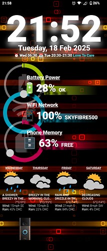

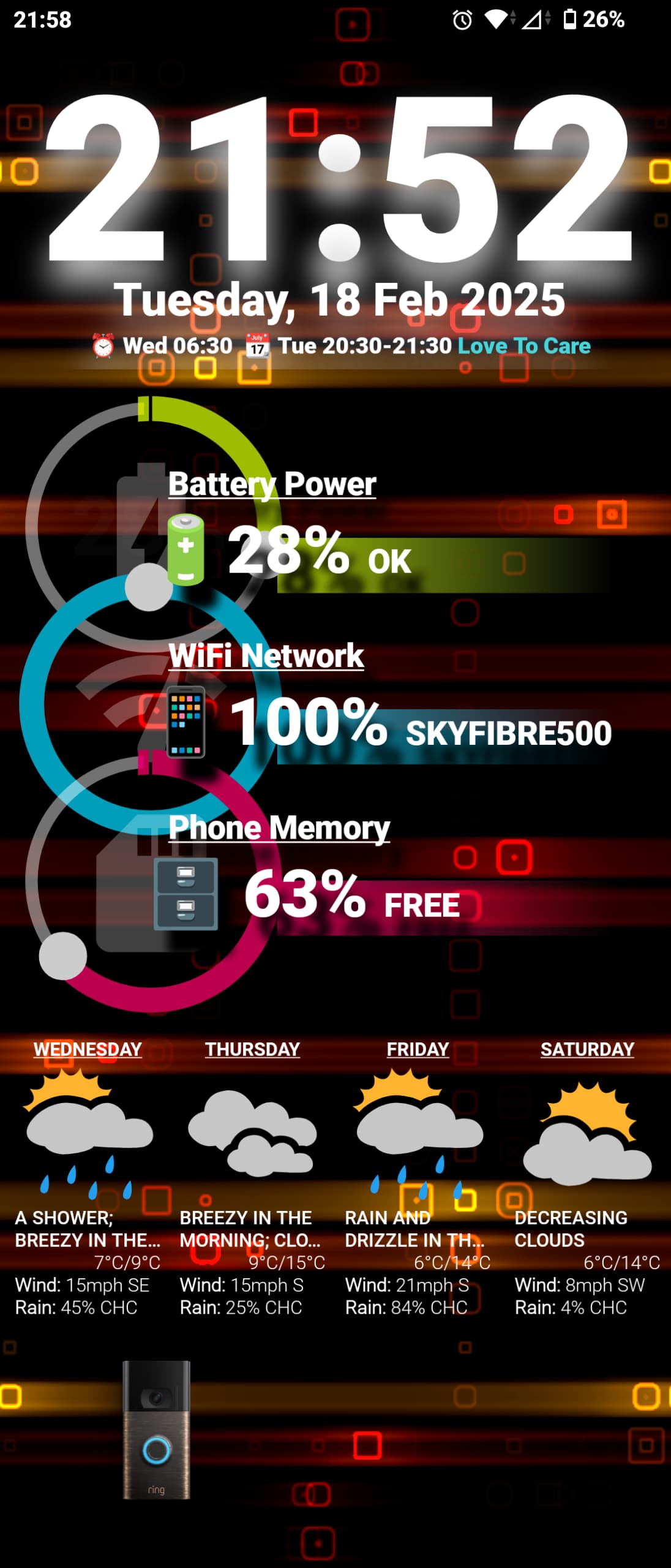

Hi
I believe I’m having similar issues
For the past several months there seems to be an issue with the KGWT widgets being very laggish to update (see pic) In the snap notice the widget clock compared to the system clock at the top of the screen. Is this an issue with the app, launcher, or OS? It’s failed to work properly both on Nova and Smart Launcher?
I really hope you solve this.
