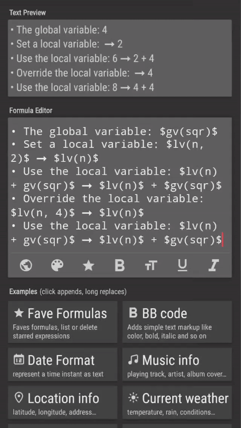

I tried your code snippet and I think it’s incorrect.
I think the issue is not about the global variable that is cached or not.
Here’s my suggestion:
Assuming that the global variable sqr has been created with its value set to 4 …
$lv(n, 2)$ ➞ define a new local variable n and set its value to 2
$lv(n) + gv(sqr)$ ➞ calculate: the local variable + the global variable
$lv(n, 4)$ ➞ Override the local variable n with the value of 4
