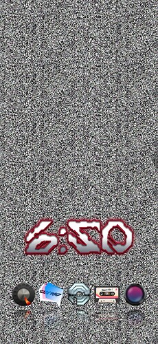

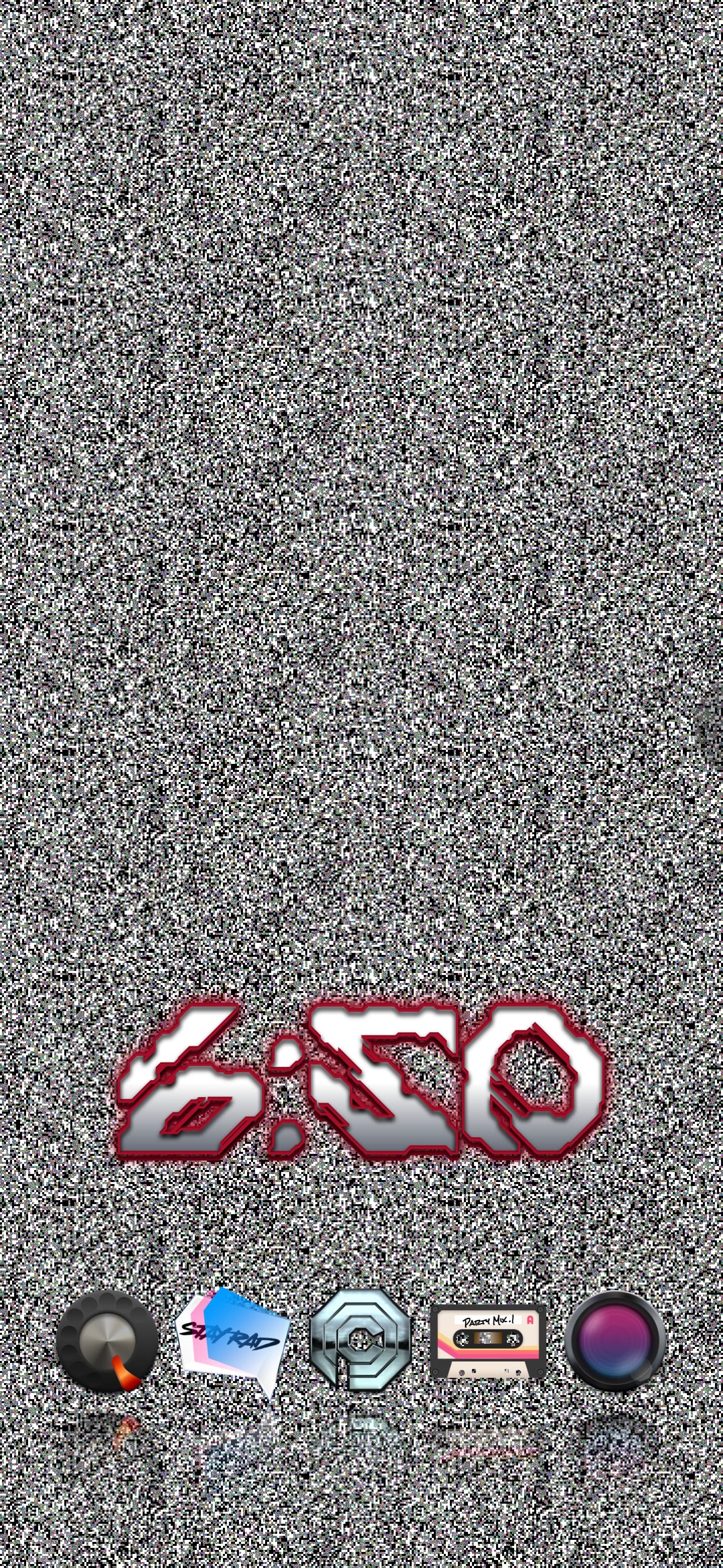

Hi, I can’t see my setup in KLWP. Everything looks fine in editor but on homescreen is only white noise.
My device is S24 Ultra and I’m using Nova launcher.
I too use a S24 Ultra and am experiencing this exaxct thing.
I think it might be something with Nova Launcher because i don’t see a problem while using OneUi launcher

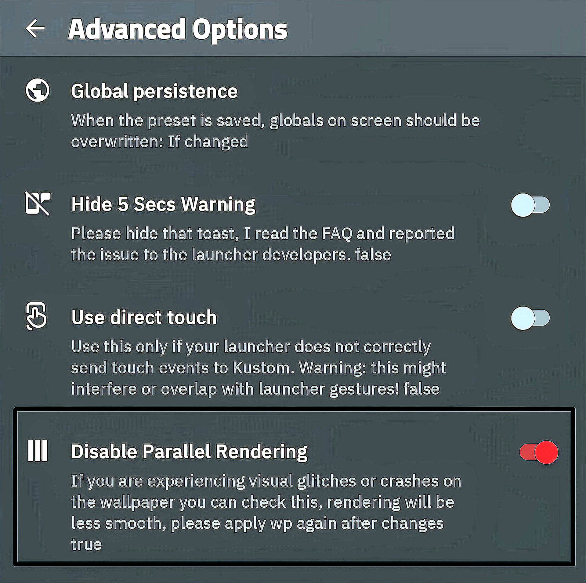

If you haven’t tried this yet, try disabling parallel rendering in Advanced Options. I had the same issue and that option fixed it for me. I believe I also uninstalled the app and then made sure to do a clean install. Good luck, hope that helps.
I’m using a Samsung A54 with OneUI 6.1, Android 14 and the last version of Nova without any issues, so possibly a One UI 7 issue, or the Parallel Rendering option?
That did the job. ThankYou
