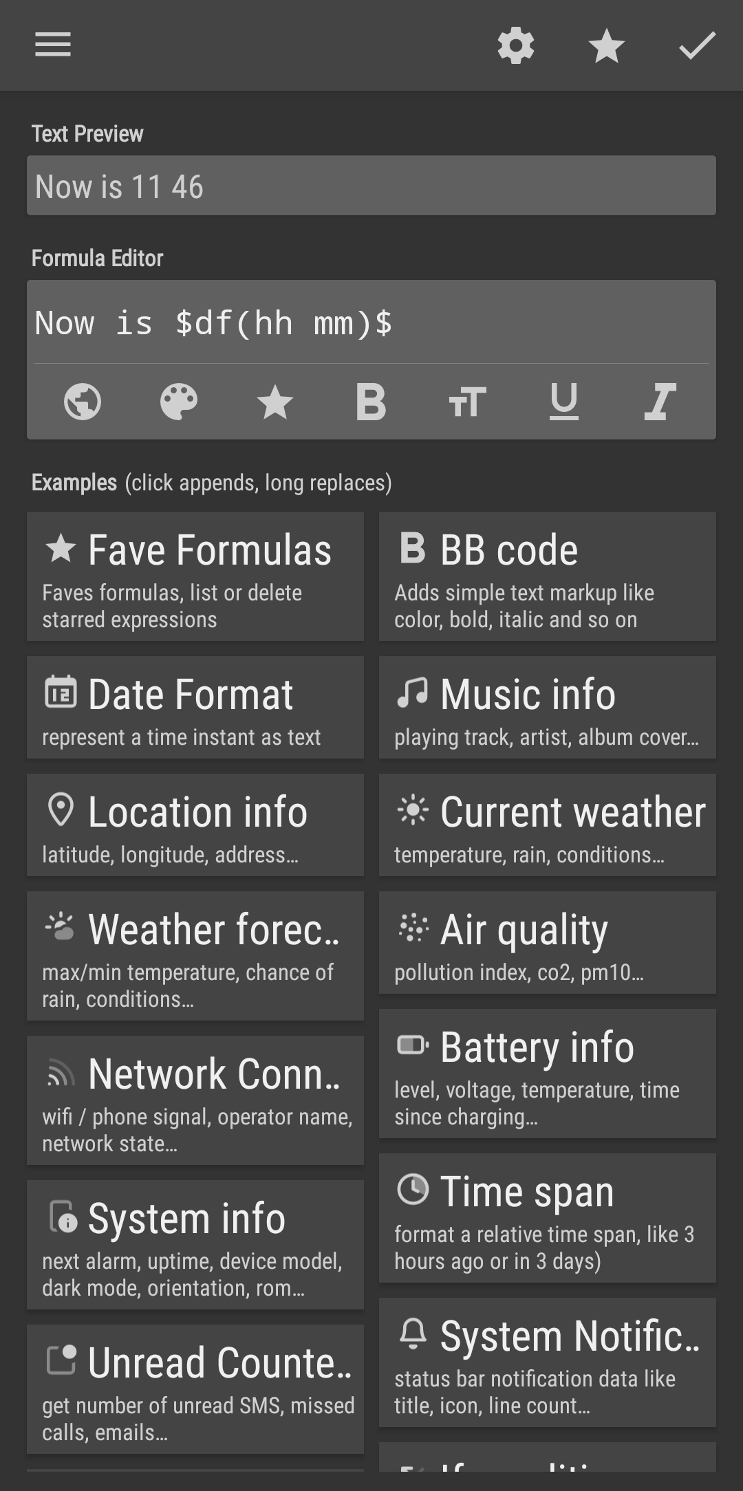

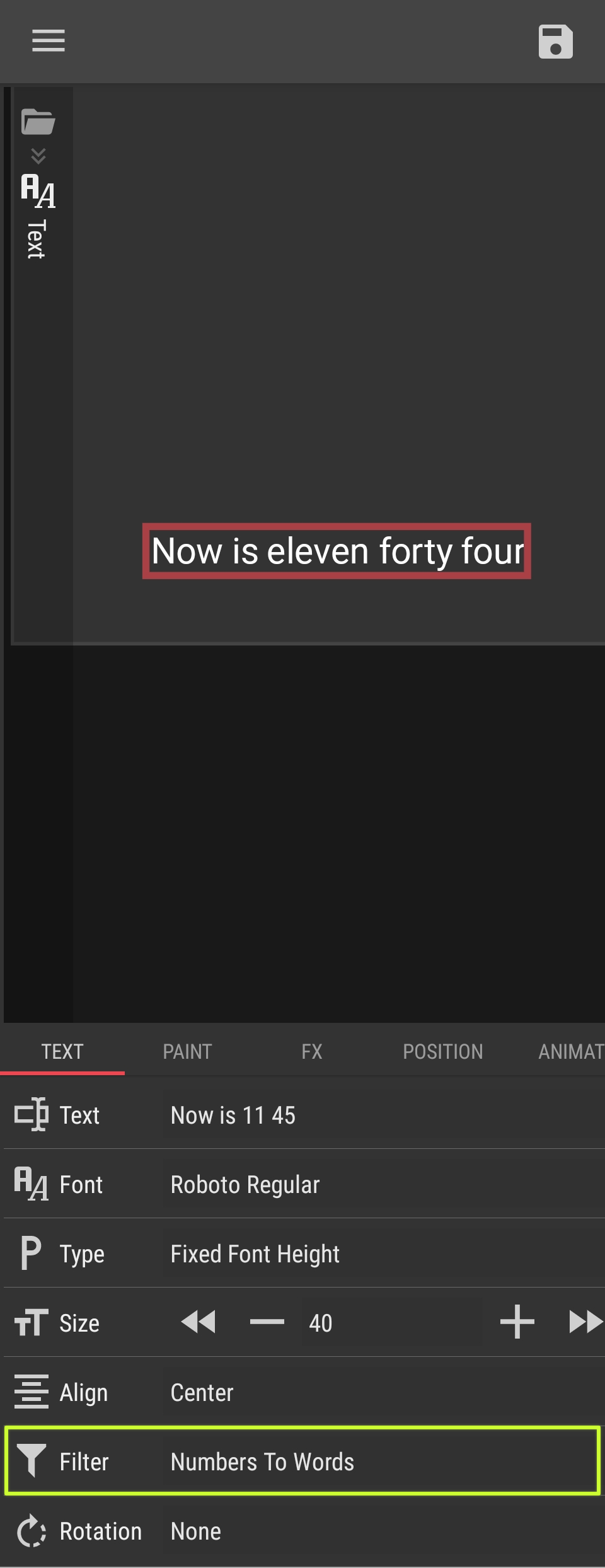

You can transform numbers to words in any Kustom apps (KWGT, KLWP, or KLCK).
