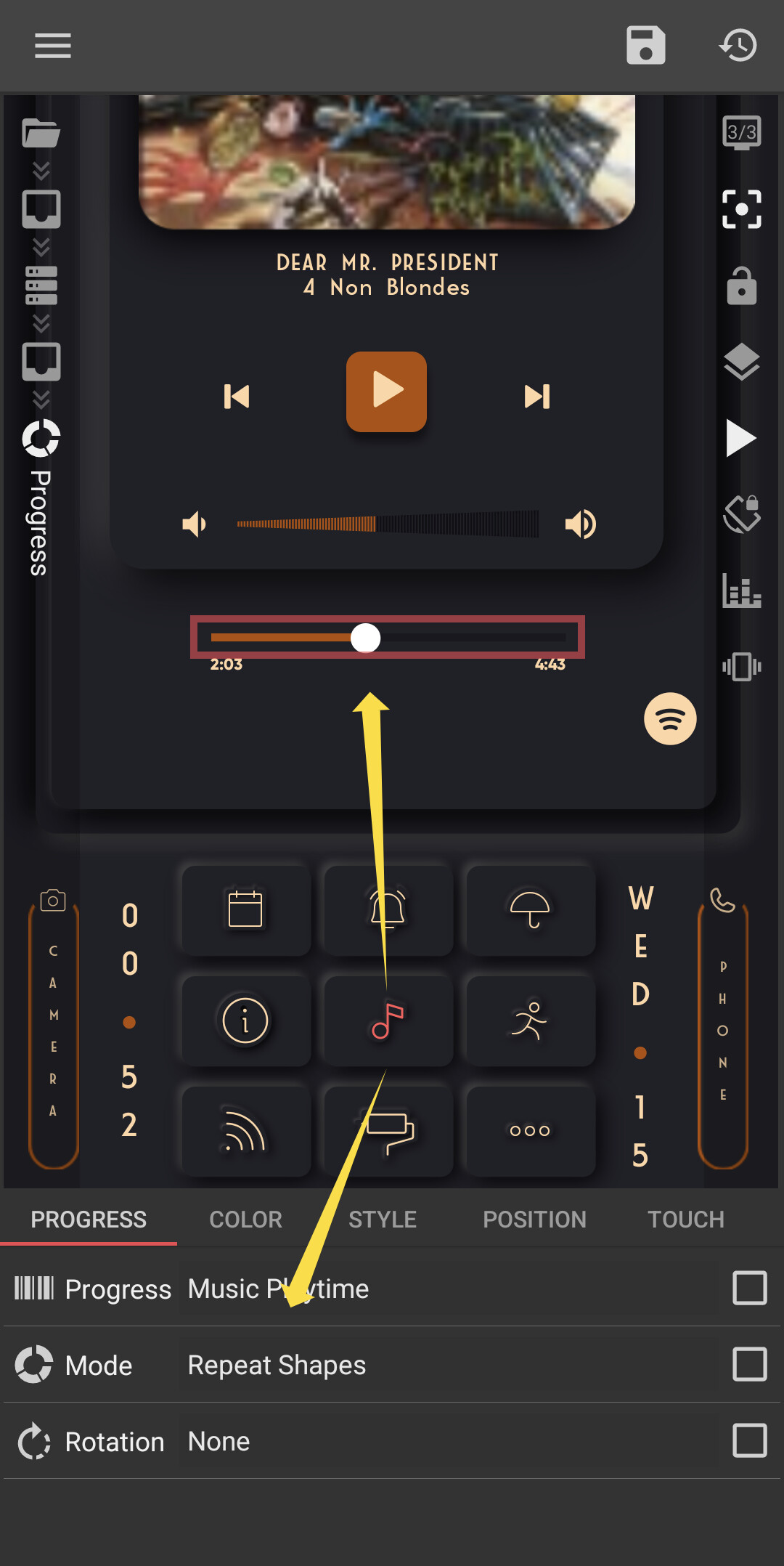

Isn’t this what you meant? (the white dot marking the front of the progress bar)
Aw… I’m trying to make one for a ring though not a straight line so I don’t believe this will help me
