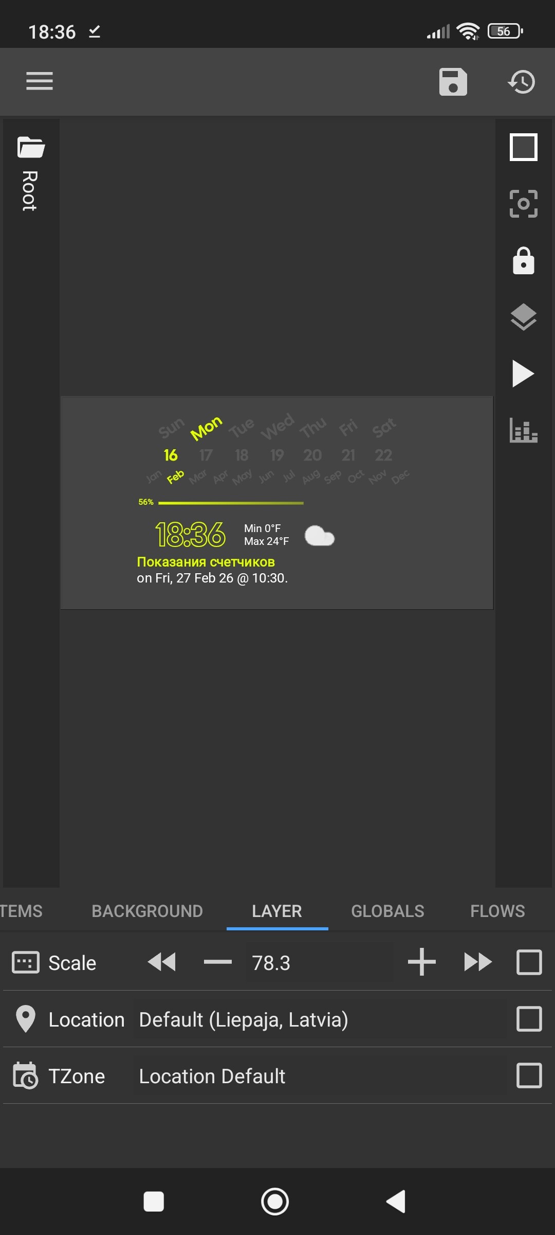

Current Day Color doesn't work

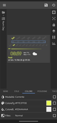

As I’ve done for day name and for month i would set current day number in a specific color. This doesn’t work only for day number. How could I fix this? What’s wrong?

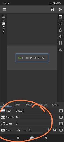

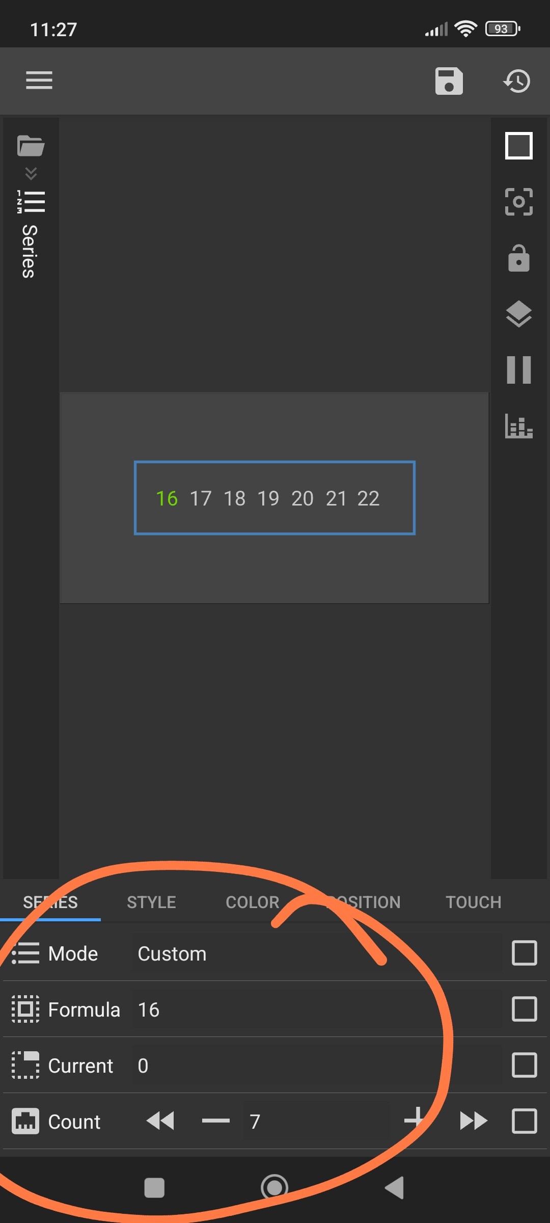

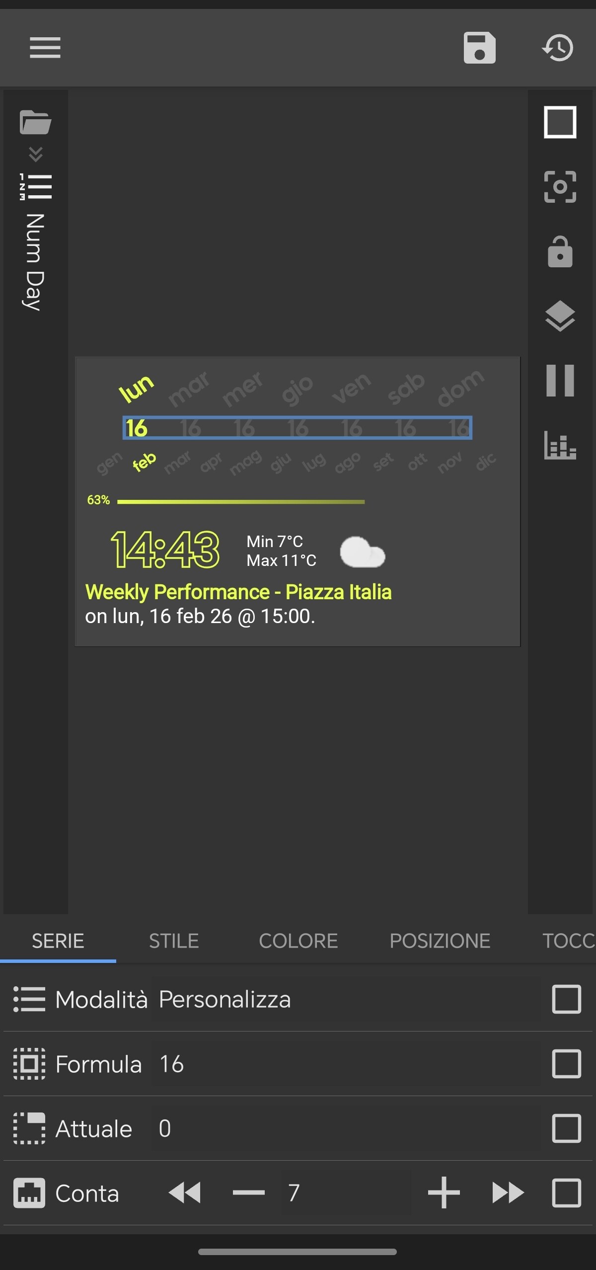

However as you can see it displays 16 in all the 7 days. How to fix?

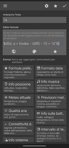

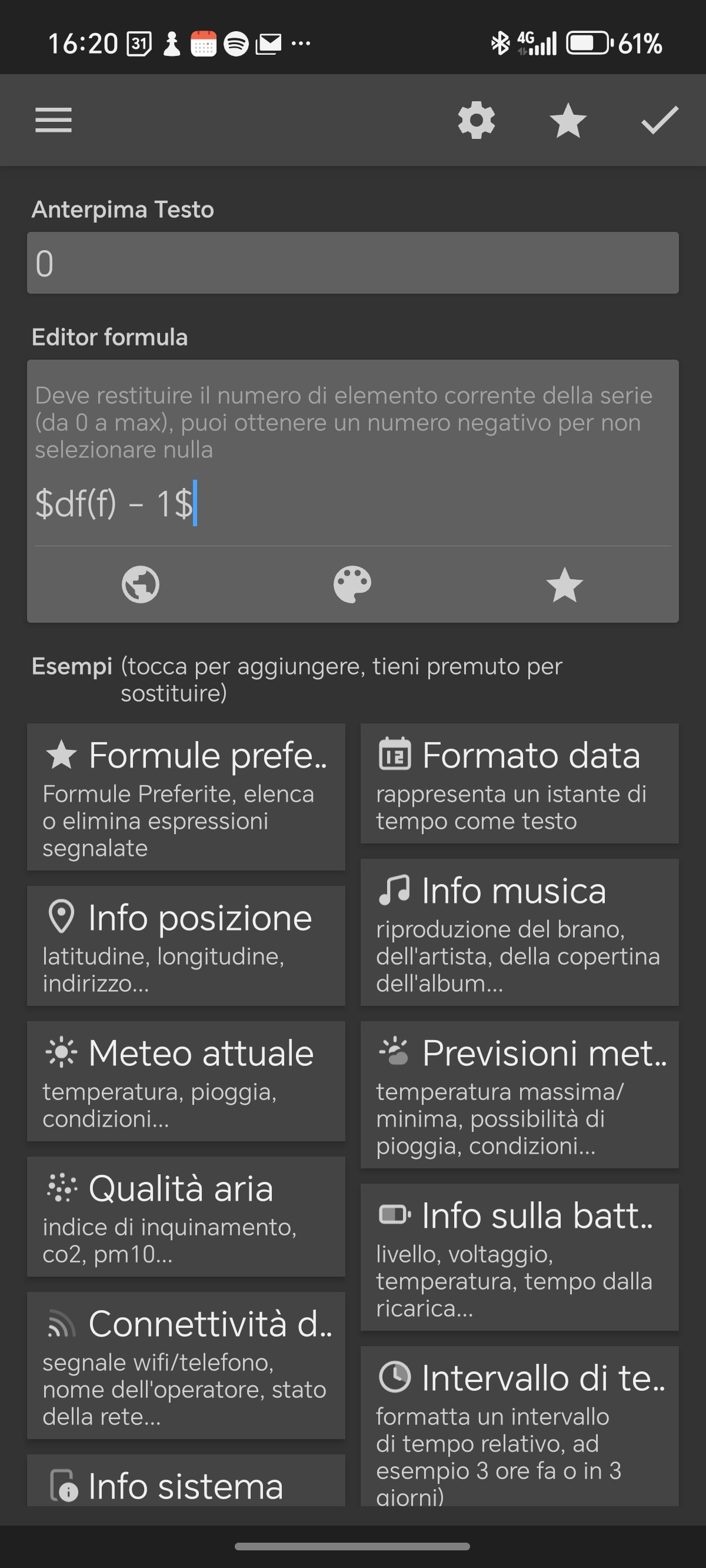

Please send screenshots of what’s inside the ‘Formula’ and ‘Current’ fields.
To make it work, your Formula must include the index variable, otherwise Kustom will just repeat the same number 7 times. Double-check if you copied my formula exactly:
$df(d, a + (index - (df(f) - 1)) + “d”)$

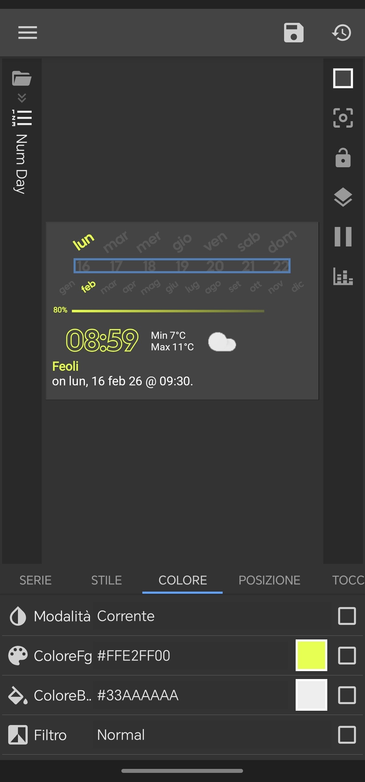

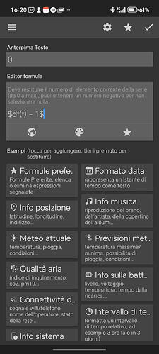

I can’t upload file and can upload 1 image per post. This is 1 of 2

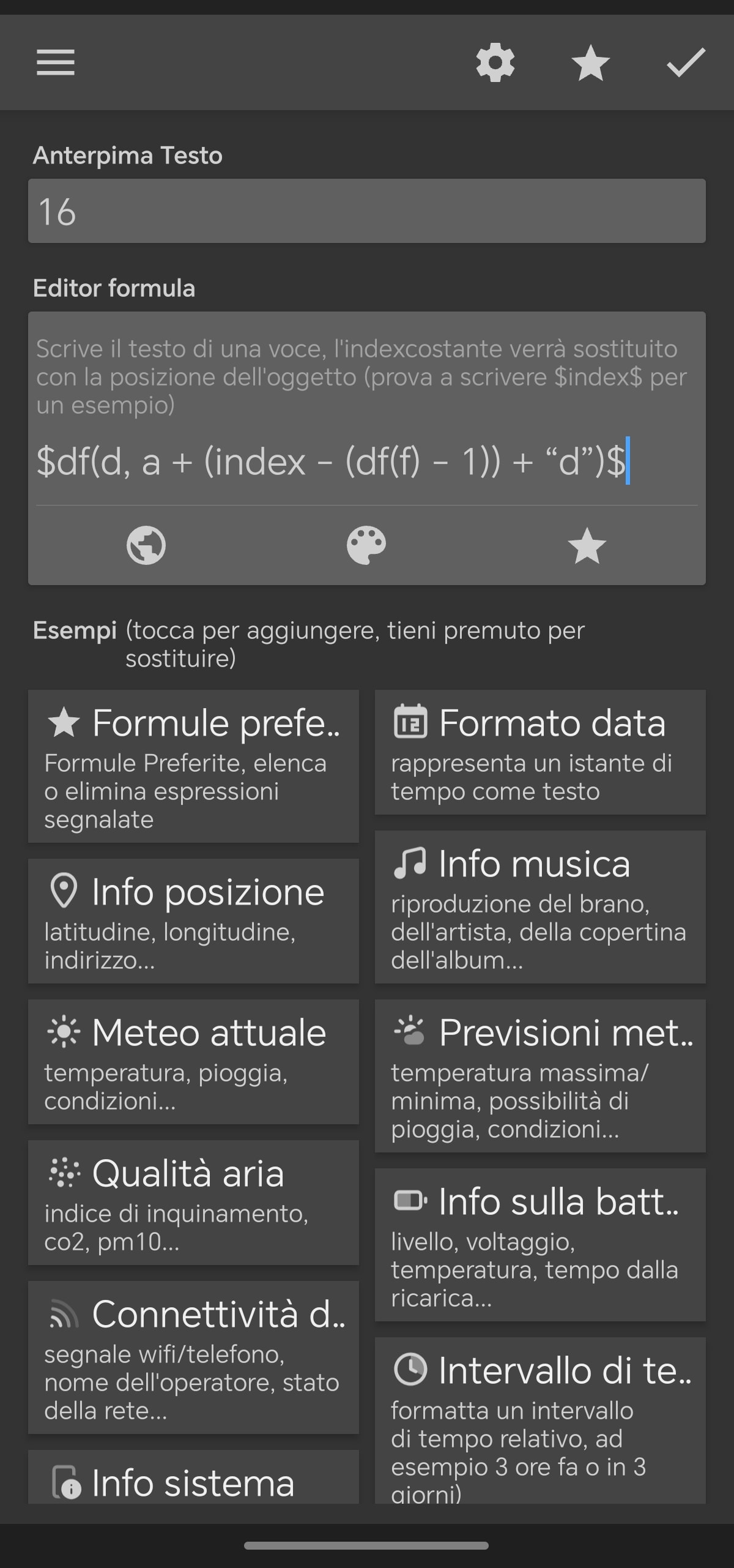

This is 2 of 2

Your error was in the quotation marks. You used ‘curly’ (typographic) quotes like “d”, which Kustom can’t read. It only accepts straight quotes.
I’ve fixed your KWGT file with the correct syntax. I’m sending it back to you now.
For a single character like d (day), you don’t even need quotation marks at all. I usually use them by habit from programming, but in Kustom, you can just write:
$df(d, a + (index - (df(f) - 1)) + d)$
This is cleaner and prevents errors when copying and pasting. Just type it manually in the editor!
