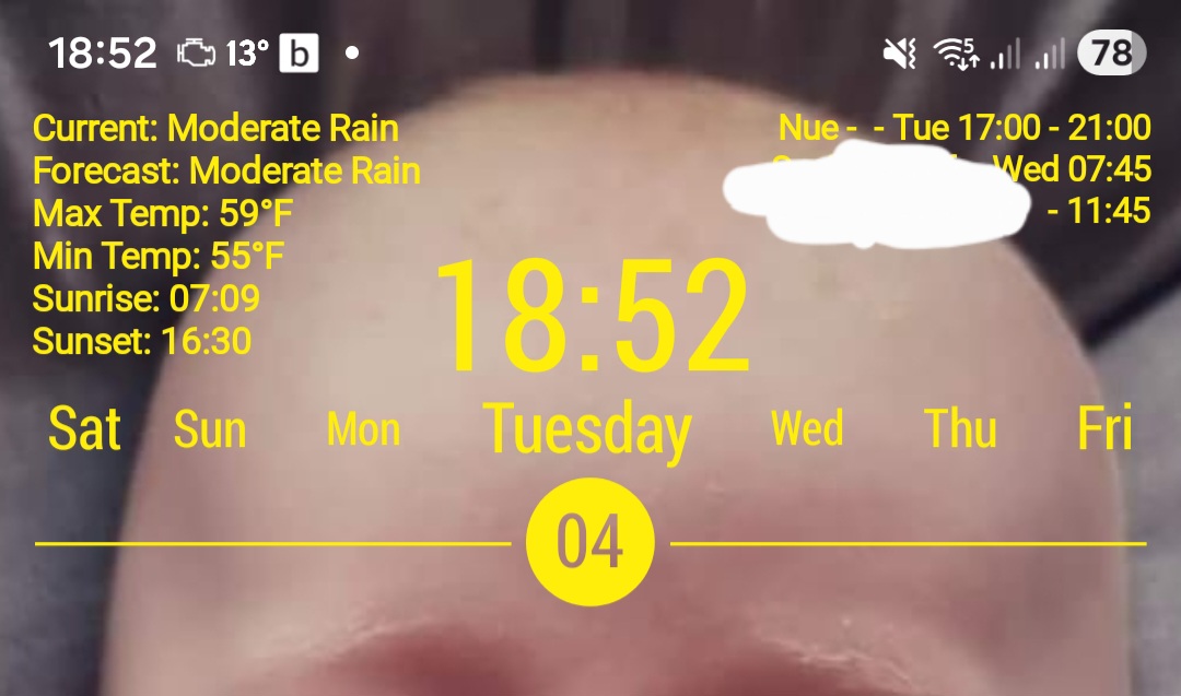

I specify ‘Capitalize’ but in just about EVERY occasion that capitals are used in my clock display the capitals are NOT correct. e.g. My diary today has NUE (means something to me) but my clock display simply has ‘Nue’. Other occurrences might be names which all have initial capital letters but not ever in my clock, they are always lower case.

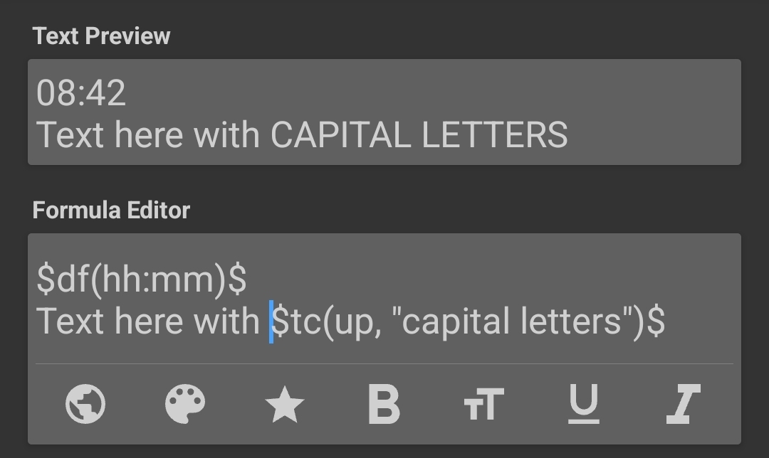

Sorry, should have been tc(up, …) not tc(cap, …)
You can click on the line where the text is and the use it like this

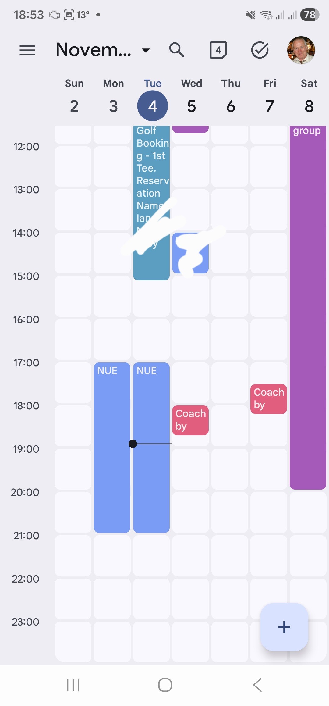

So, if this has worked there are 2 screenshots below. Yes, it’s Google calendar and this is just a basic example of what’s happening. Google calender has NUE on Tuesday and Wednesday afternoon while on my clock it’s Nue. Sometimes a similar ‘event’ could show as ‘nue’.
