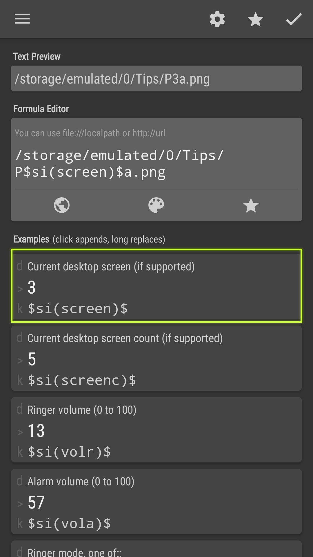

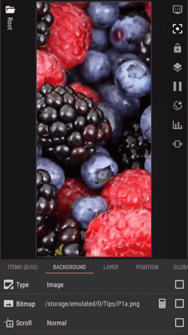

TIPS • Simple Page Background Images
Use the following script to set the background image of the live wallpaper, based on the page/screen index.
/storage/emulated/0/Tips/P$si(screen)$a.png
NOTES
  • /storage/emulated/0/Tips/ ➞ custom file path, change it to your need
  • P$si(screen)$a.png ➞ filename with page/screen index
